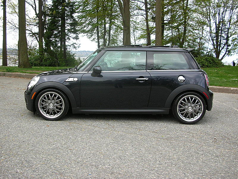

Just got my H&R Coilovers installed yesterday. Figured I throw up a couple of pics that I took this morning.
I told the guys that did the install that I wanted it dropped about "2 fingers". Ended up being a little more then an inch.
Haven't got an alignment yet or put much miles on them, but so far so good. Definitely firmer, but not harsh or jarring over seams and expansion joints. There does seem to be a bit of a bounce or pulse, but I would assume and expect that to go away once they get used a bit.

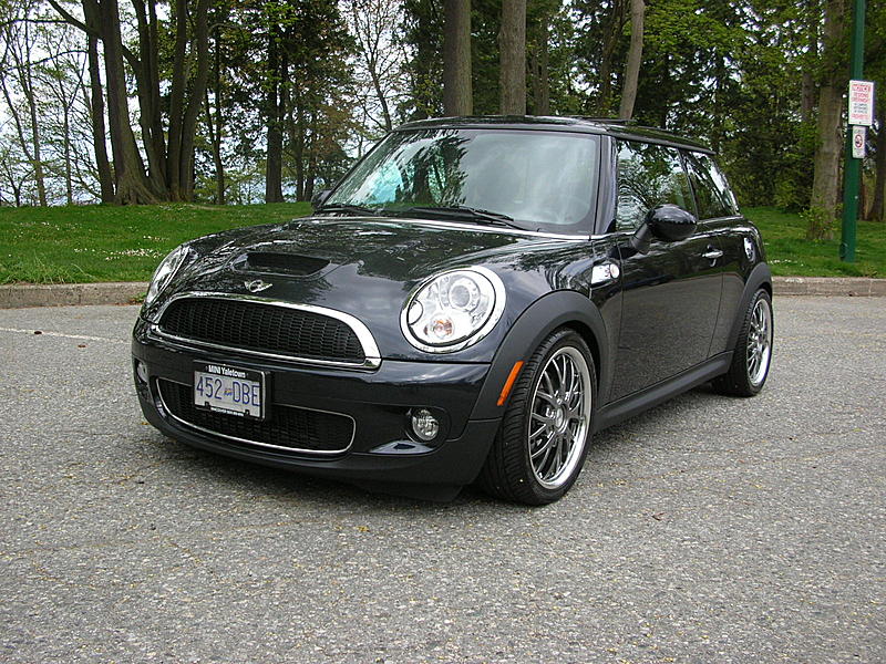

installed RSS Coilovers
I installed my H&R RSS ClubSport coilovers on Saturday. They dropped the car more than I expected, but looks really good. I took it out for a spirited drive on the back roads and was amazed at the agility and responsiveness. The faster I went the more impressed I was with the cornering ability. Driving around locally the car felt solid but without the harshness I would have expected out of a sport/track type suspension setup. I currently have the front struts adjusted to the top threads and still only have a tad over a finger width clearance between fender and tire..but no rubbing issues. I do have to be cautious with the underbody clearance though as I have the Alta cat-back exhaust and the clearance of the resonator in the midpipe is only about 3.5 inches...watch those speedbumps. The darn exhaust sits quite a bit lower than the stock exhaust...hope that doesn't create issues.
Adam, thanks for the install tips...went smooth..about 4hrs to install and the 2nd of each front/rear went much faster once I'd figured everything out. Any tips/advice regarding ground clearance with the Alta exhaust. I love the exhaust but am worried I'm going to rip the thing off on a speedbump or something. I have an 06 Cooper S with Alta 22MM rear bar, OZ 16 inchers with 205/50/16 Yoko E100s

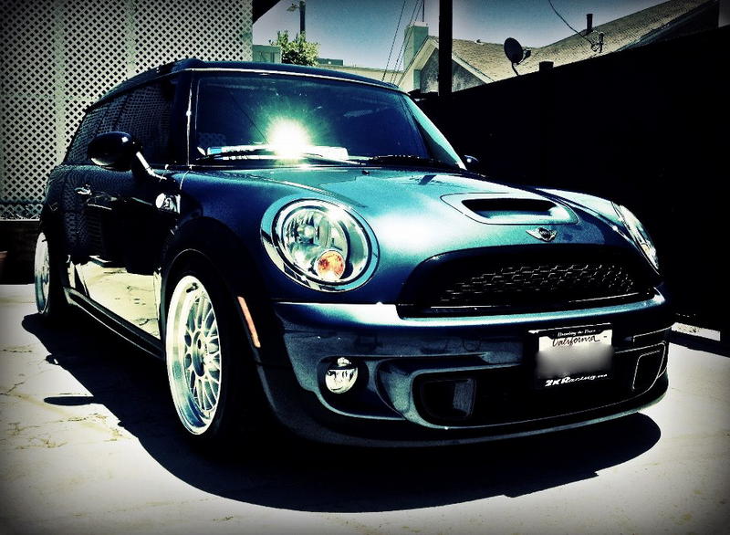

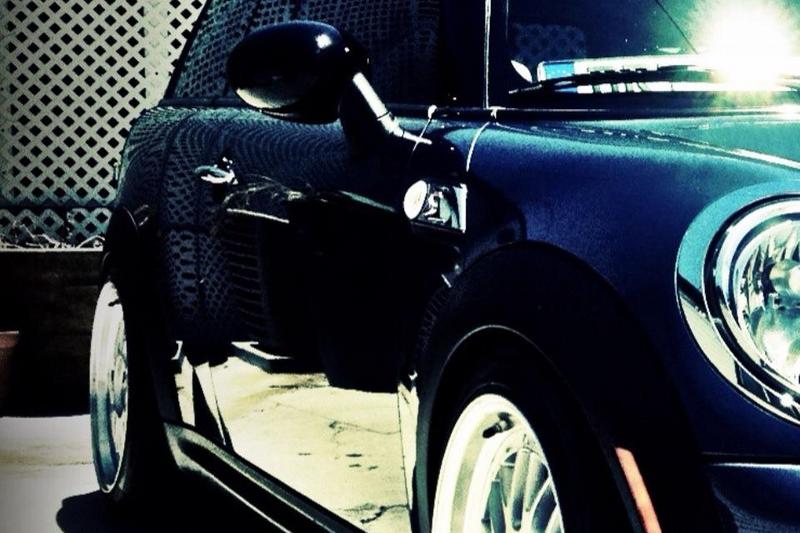

DRT NaSTY's Avatar
DRT NaSTY
Joined: Jul 2012
Posts: 144
From: Los Angeles
2011 Clubman S
H&R Street Performance Coilovers
amongst other performance mods.
