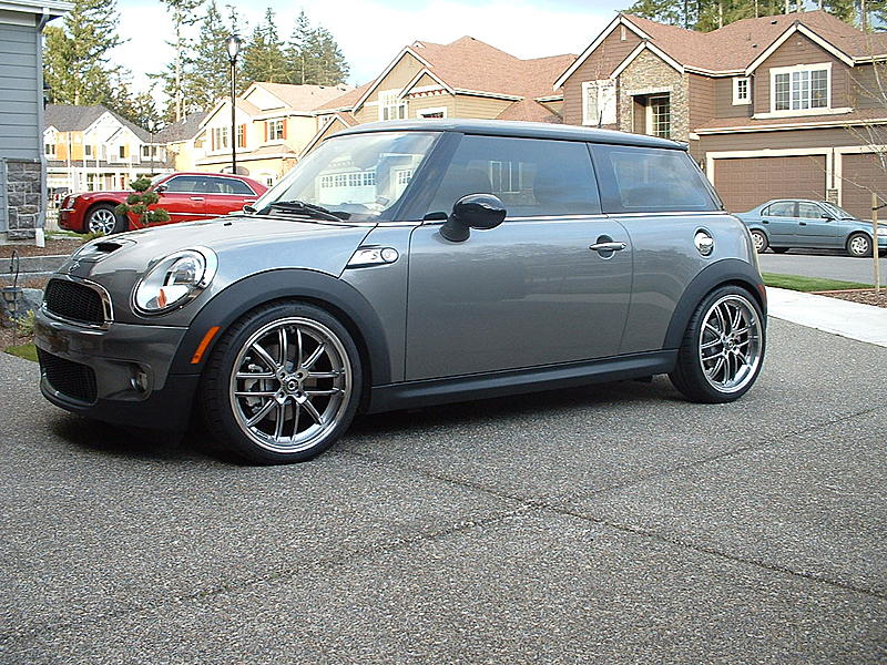

Here is a pic right after H&R Street Perf coilover install and new PS2's that replaced the Toyo Proxes 4's. Still have to mess with small ride height adjustments and probably install a 19mm RSB.

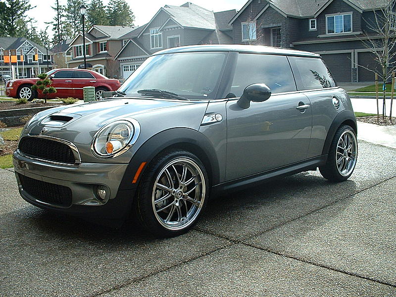

Other pic is a before coilover install shot. Here are some after pic's.
Attached Thumbnails Installed H&R Coilovers-dscf0044.jpg   Installed H&R Coilovers-dscf0037.jpg

Looks good VJD, much better
How much did you lower your car?
I have a set of these coilovers on order. Have to wait a couple of weeks to get them as they are on backorder. I plan on lowering my about 1".
Give us a review of them after you've put some miles on.

When I took the pic's right after the installation, the front spring perches where set at the top and rears mid position. As pictured, the front is as high as it will go, the rear's can be adjusted up or down. The ride is not overly stiff or harsh and for some folks, who want to track their cars, this set up might be a bit soft. It is just right for me as I will not track my Mini. With the addition of a larger RSB, this setup should be good for street use.

VJD, nice pics It looks like you've got 18" rims on your MCS, are you having any problems with the tires rubbing or with ground clearance?

Thanks. Yes I have 18's. They are Konig Again 4's, 18/7.5 with ET45mm. Tires are 205/40/18, Michelin PS2's. No rubbing or ground clearance issues.
