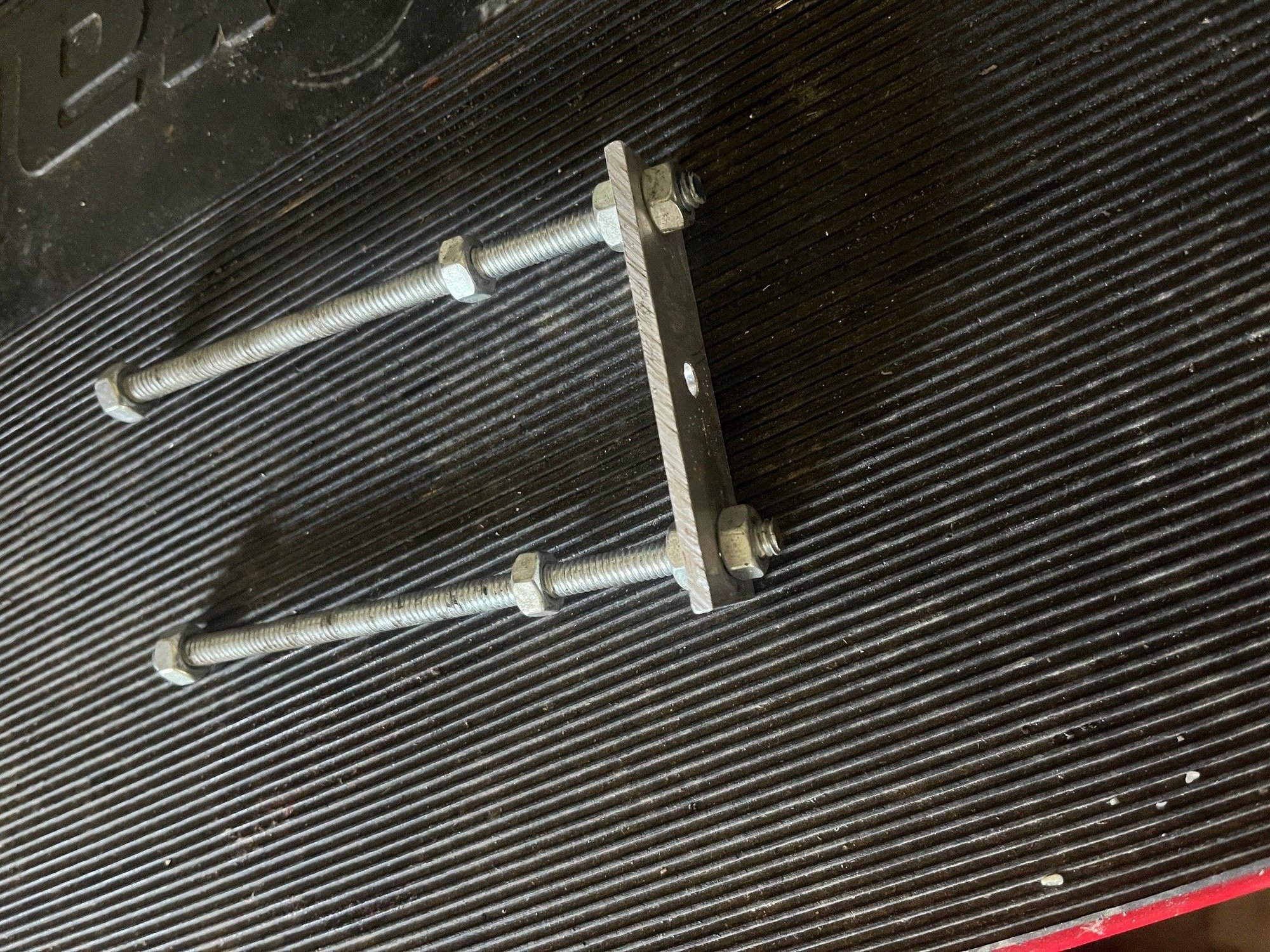

2. It's easy to make a special tool with some pieces of threaded rod and a piece of metal or wood. It's purpose is to hold the piston/pushrod in the fully retracted position thereby minimizing the volume inside the slave. I'm not convinced it does much, but I've always used it and never had any issues. Side note, when removing the tool make sure the pushrod extends SLOWLY otherwise air will be sucked in through the slave seals. Below is one I made a long time ago.

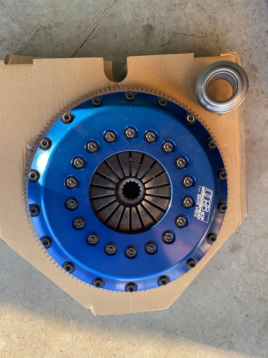

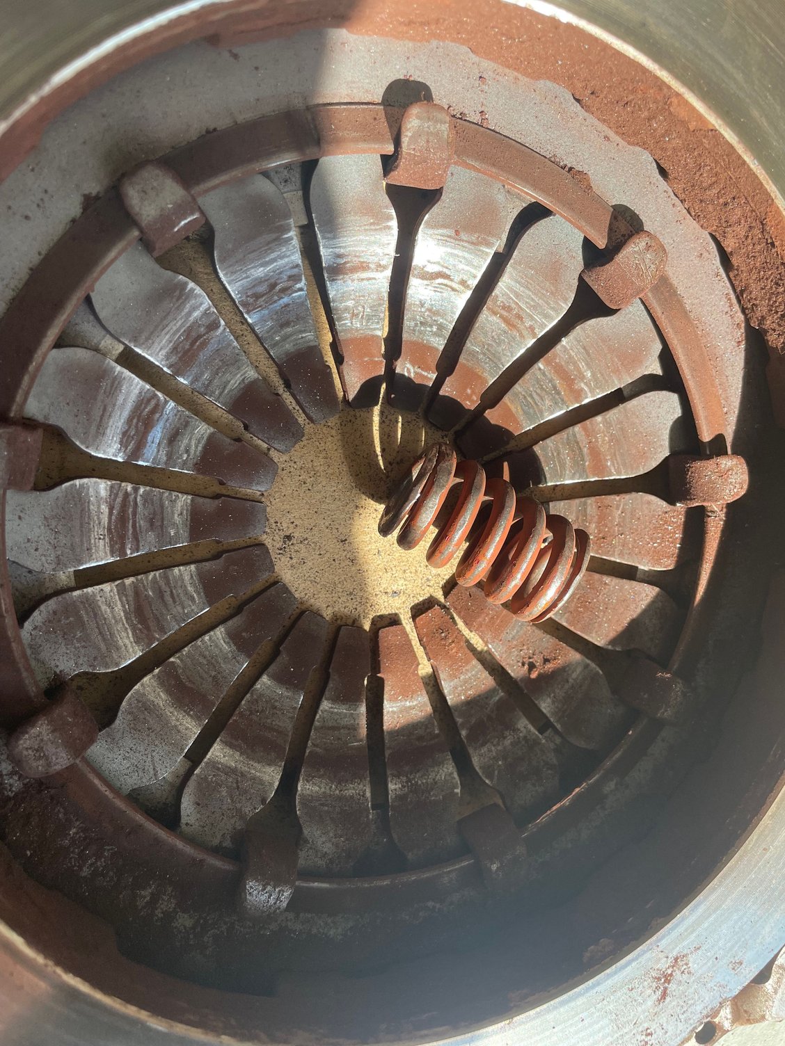

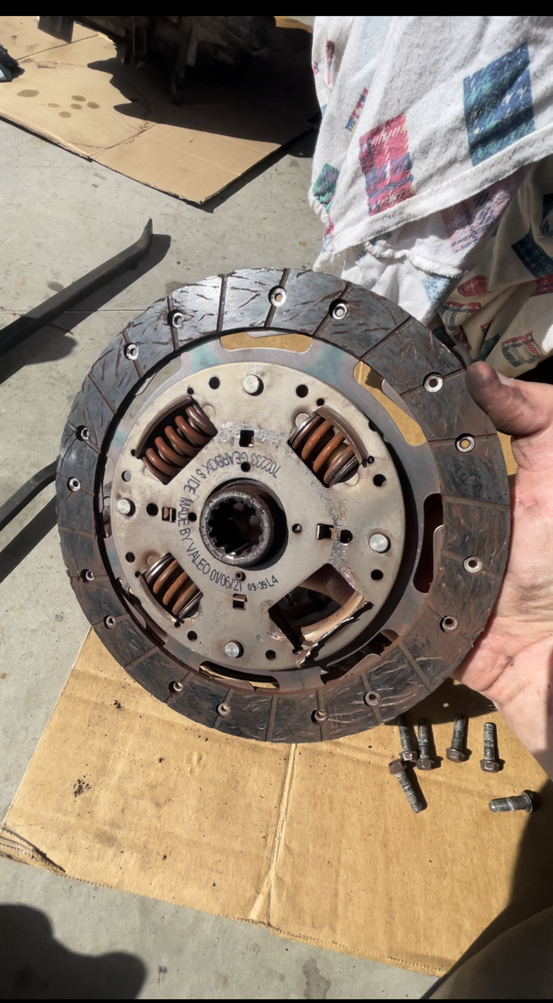

I have some good/bad news regarding my Mini Cooper S with this concern. I towed the Mini home and pulled the transmission. I found one of the dampening springs on the Valeo Friction Disc let loose into the space between the disc and the pressure diaphragm. Seeing as I'm running a rebuilt Thumper Engine TPR2-R Cylinder Head and other parts, I opted for a stronger/more aggressive clutch. The OS Giken STR is now mounted to my engine. It's amazing quality and gripping performance. Making it nearly and on/off switch. But I'm happy with it. The Valeo Kit weights 35.2lbs whereas the OS Giken weights 23.2lbs.
I have photos, but at the moment they are to large memory wise to share.
But again, my clutch stopped working because the disc body failed allowing the dampening spring to get wedged preventing disengagement.
