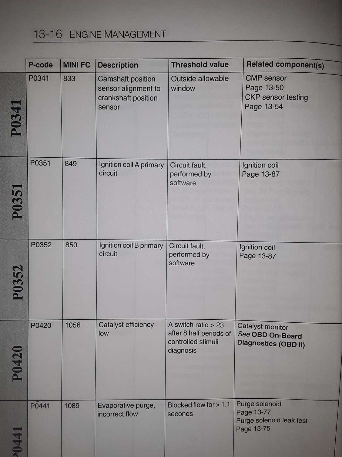

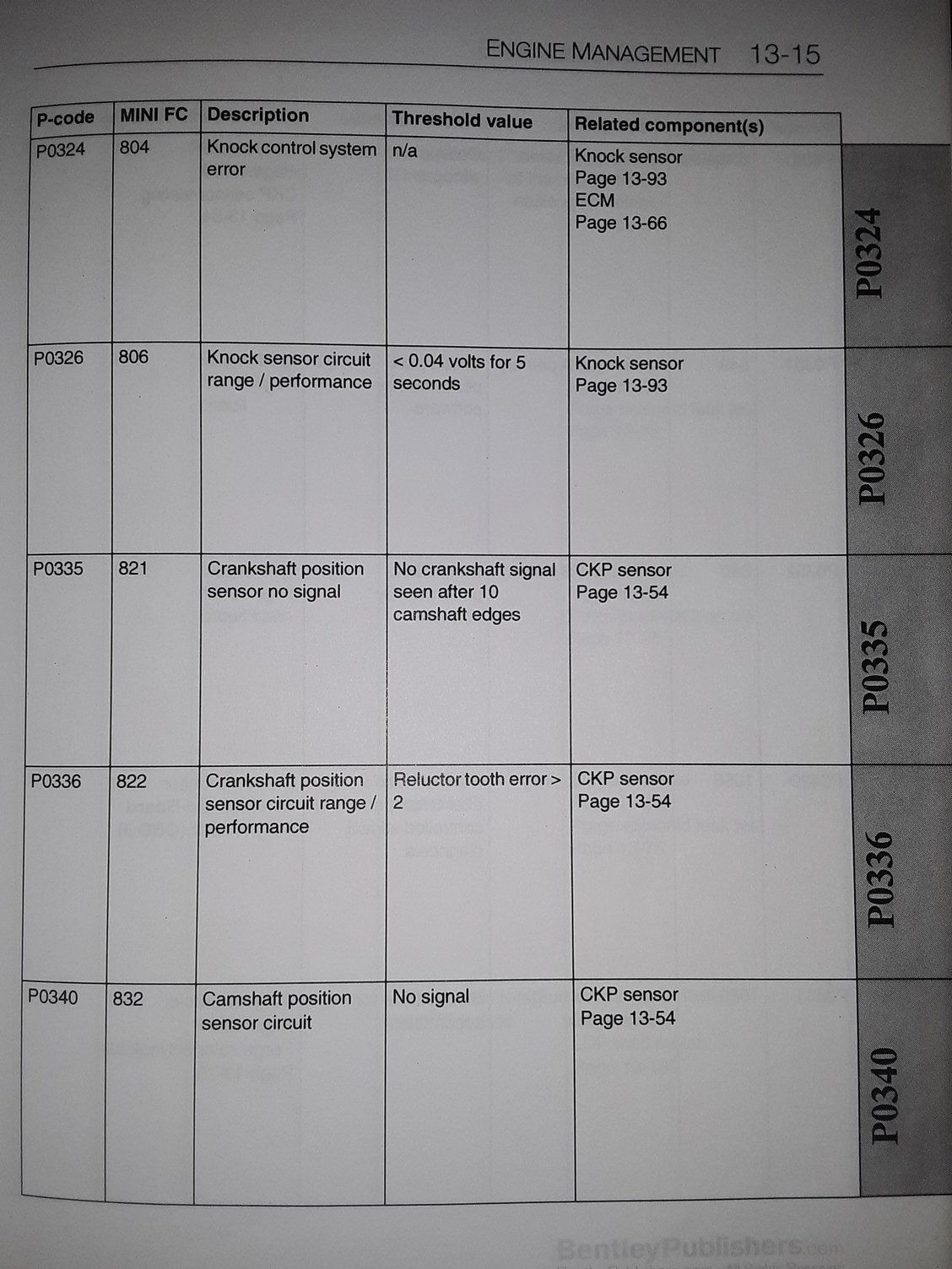

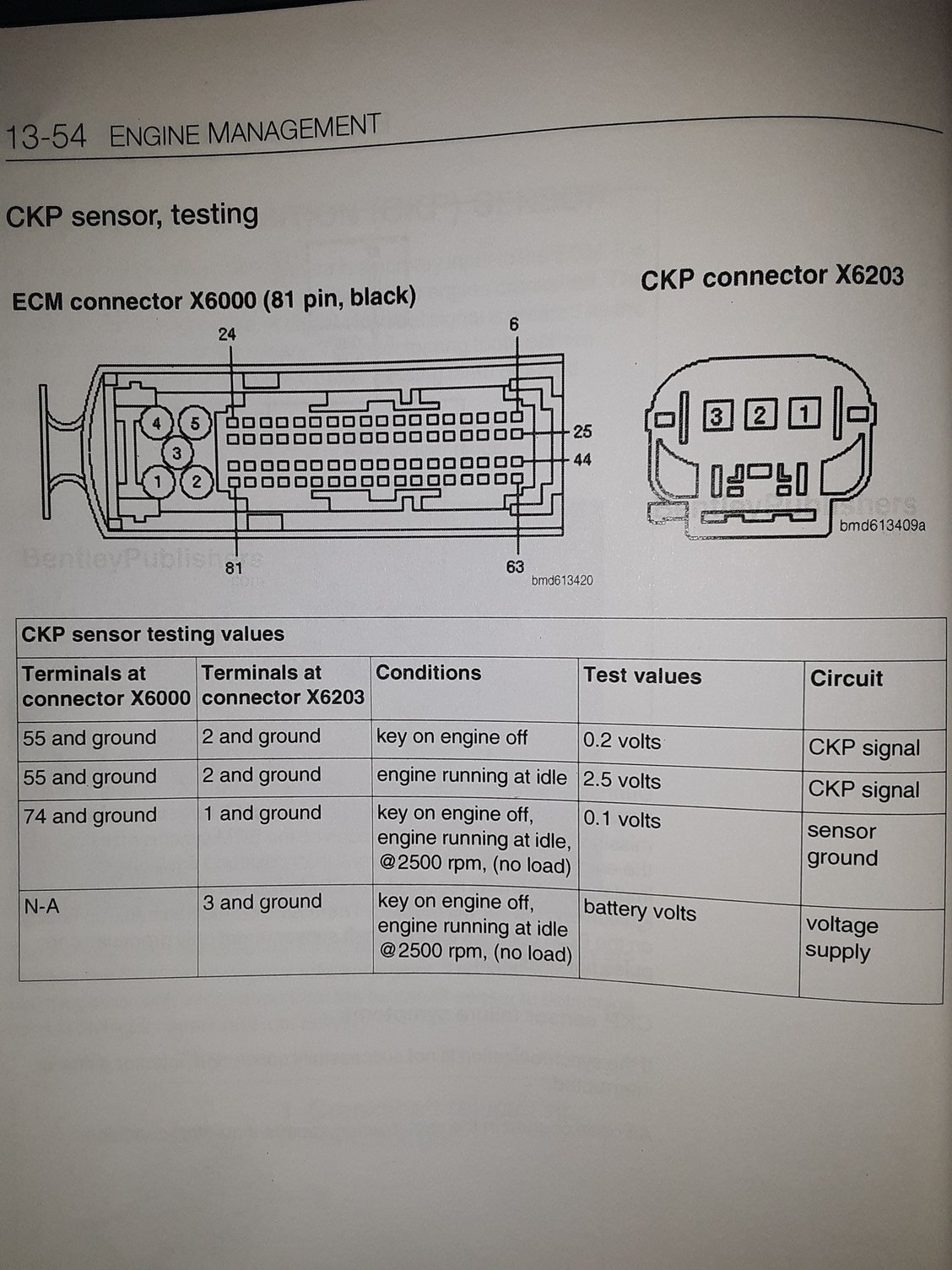

In case this helps, from the Bentley "2002-2006 MINI Diagnosis Without Guesswork" book

Thank you @Daftlad for posting the above information!! This will be really helpful when I do a deeper dive into the wiring. The wiring part is fairly simple when you have the expected values and pins to rule out with a 3 wire sensor, basically you have:
  • B+ to the sensor (Pin 1)
  • ECM supplied ground (Pin 3)
  • Feedback from the sensor to the ECM (Pin 2)
Since the values at the sensor seemed ok, I suspect that this is a bit intermittent and the issue occurs with a certain amount of load. My plan of attack will be to perform overlays to completely rule out the wiring. I will start by supplying a constant ground to pin 3 and if the code still sets, I will supply battery voltage to pin 1. This will be done at or near the sensor and if I have the correct pins, I will just de-pin the harness and add these as jumpers directly into the connector. If neither of these make a difference, I will overlay the signal wire (pin 2) from the sensor to the ECM.
As a last resort, I will replace the ECM. Luckily, there is a guy nearby that parts these out and has ECMs with keys, immobilizer units, ignition, switched, and key cylinders. I will use this thread to report back any new information, including the eventual resolution.
