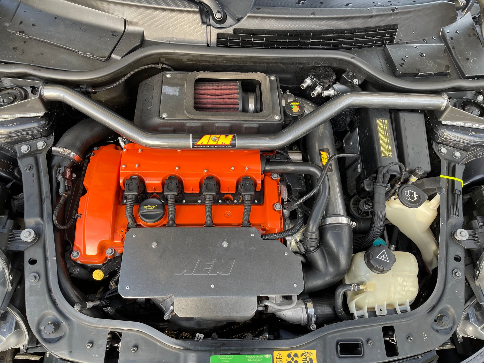

I am currently running the Amazon one, it’s been great for the last 5-6k miles of all kinds of driving. The pcv system is serviceable on it unlike any of the factory ones. It’s all aluminum other than the pcv part.
I am also using the Hamburg version on another n14 and I have zero issues with it. I went with the Amazon one because 1) needed a new one and 2) wanted to see the quality and if heat is an issue again, this one won’t melt.

So, now I'm back to the Amazon one, I don't like the idea of melting...
Can you tell me which "brand" of the Amazon one you got? I guess go with the seller with the most sales.
That's plastic under the coil packs, though, right? There's plastic parts under that upper cover, as well? Or that is literally the "pcv part".
How does that hose that comes off to the right anchor? Does it come with something, or use the "bow" or clip or whatchamacallit that keeps it from coming out on the original (and that a mechanic lost...)
Assume comes with gasket? (Yea, I need to go back and re-read the Amazon listing...)
That AEM heat shield over the turbo looks practical - like, what should have been there in the first place. Was not familiar with the brand, will look it up. Of COURSE my plastic one is partially melted.
This makes me very happy, as I've always tried to see if I can do an upgrade at same parts cost when possible when I need service parts. For example, needed brake hoses, so braided brake hoses.
Many questions, but home stretch.

the hose connects the same as the factory one, but it fits pretty tight I didn’t use the clip. The black piece you see is plastic, it is the pcv system, and it does come with a gasket. Everything orange is metal though, all serviceable by removing the screws. I had a turbo blanket as well but it ripped in half when the studs backed out, the aem shield saved stuff from catching on fire/melting. I’ve got the stock shield and the aem for now though and have no issues.

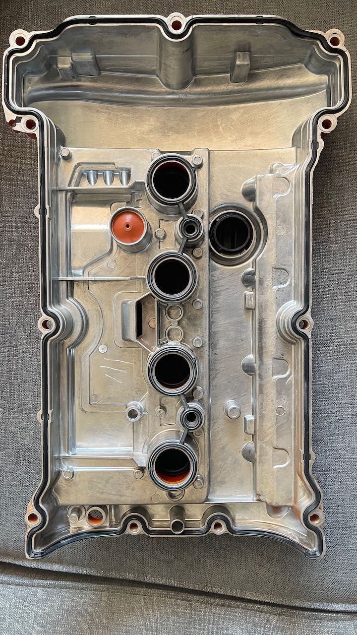

I got the "Mitzone" brand aluminum valve cover on Amazon. It looks great! But a couple of concerns:
(1) There are bosses on the bottom at each of the bolt holes. They are off-center, and some have nasty burrs. What if anything should be done about this. Or return for refund or exchange? See photos.
Mitzone aluminum valve cover bottom
Mitzone aluminum valve cover burr detail
Mitzone aluminum valve cover, painted inside oil filler
(2) It's painted. On the outside, but... a bit of concern about the paint around inside of oil filler. Clearly, the paint will flake, the idea of paint flaking into the top end seems a bit horrifying. I honestly don't care if the paint on the outside flakes. I didn't buy this for appearance, but to once and for all keep the oil inside where the oil belongs.
