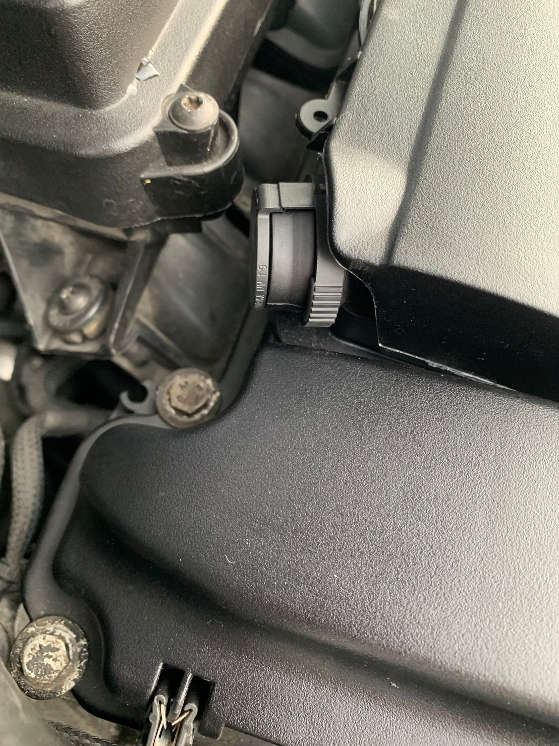

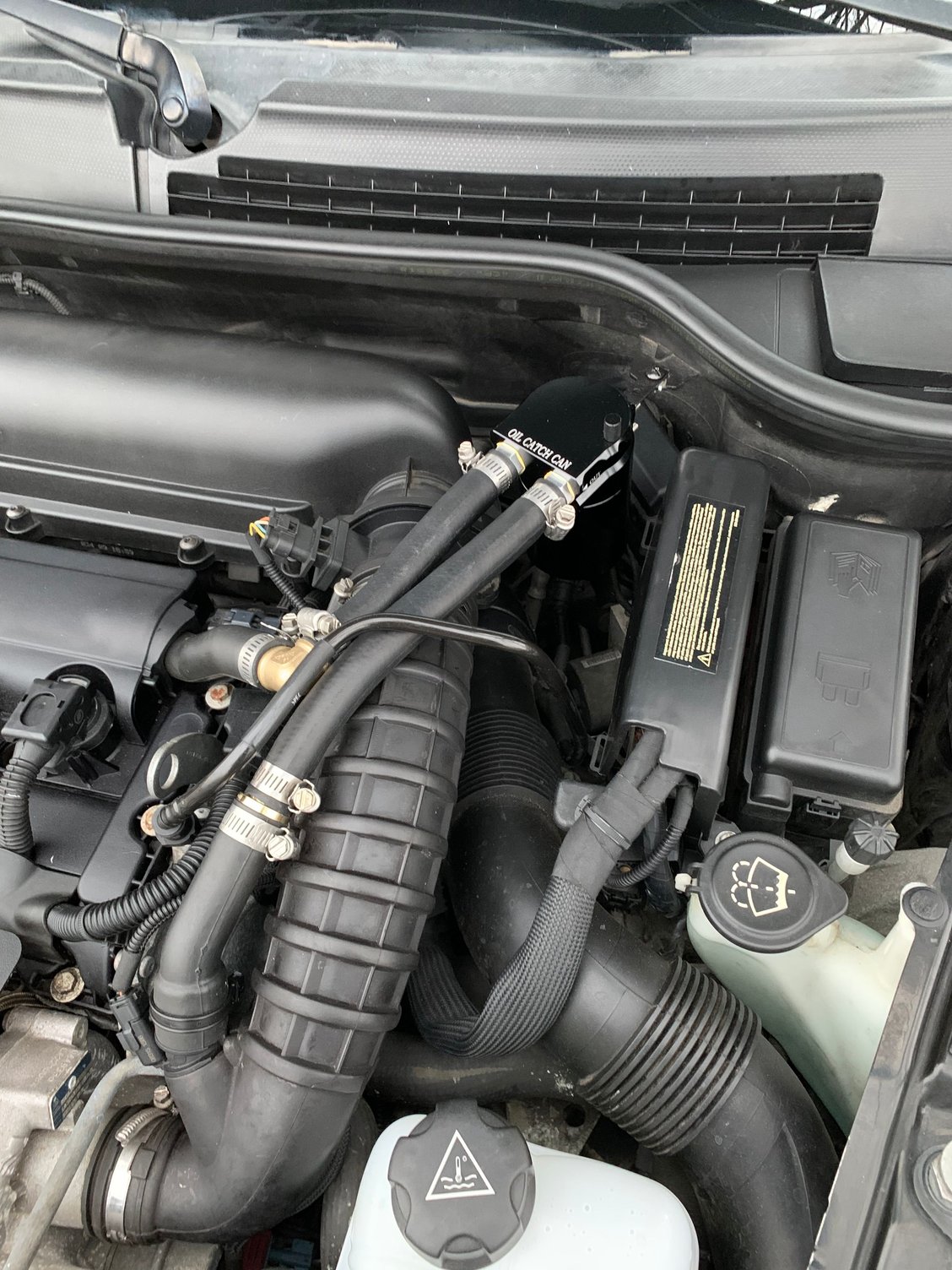

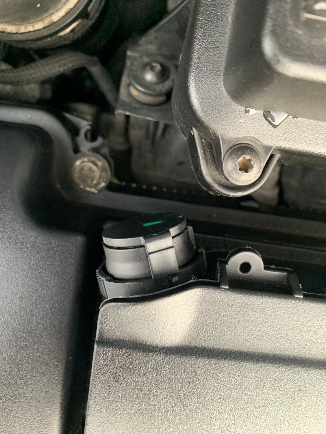

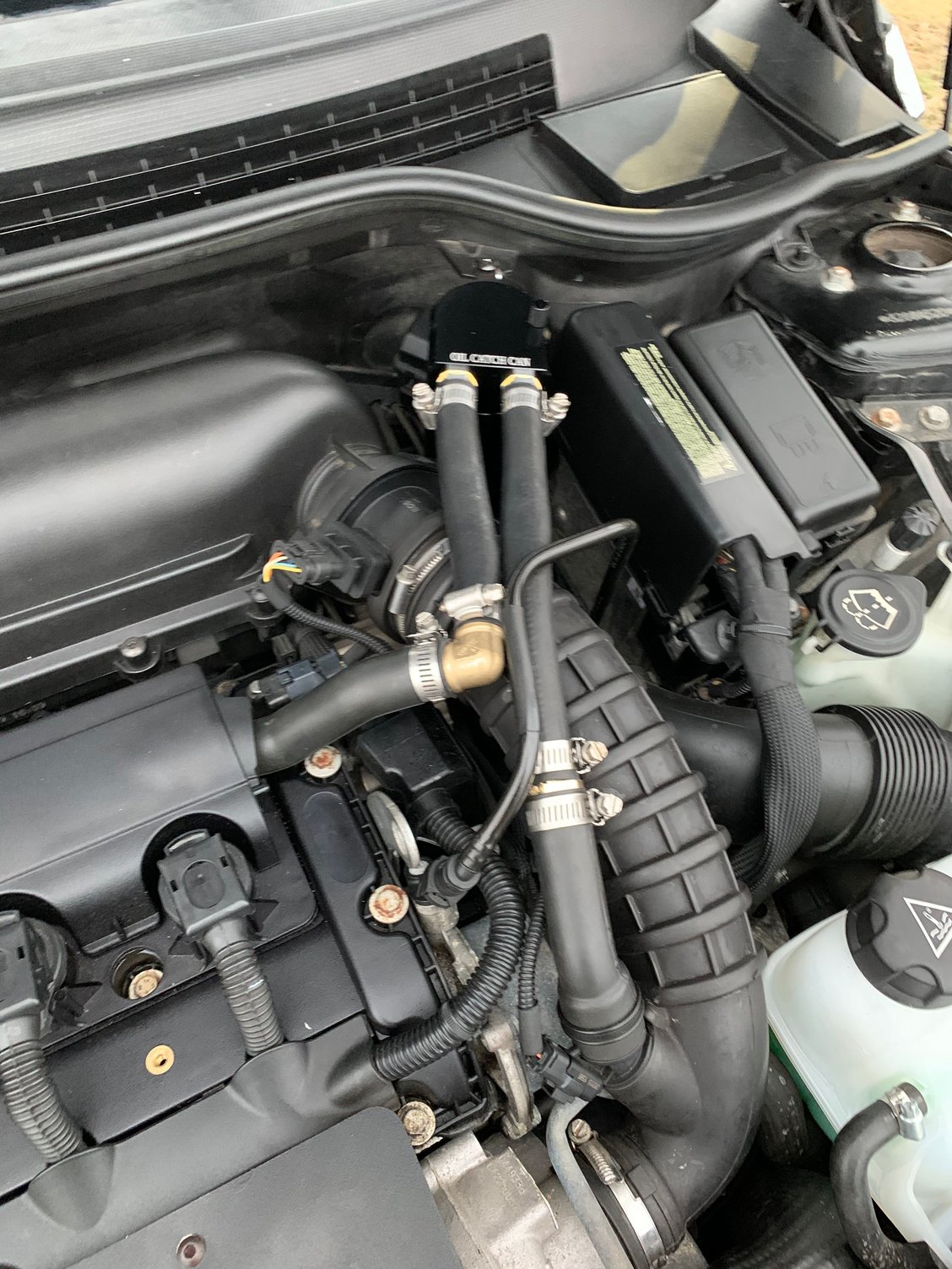

I will try to take some pics of what I can, at lunch today. On the n14 it has 2 of them. One runs from the back passenger side, this is the one I blocked at valve cover and down on intake manifold, the other one is over one drivers side that runs into air intake tube pre turbo, this is where I have DIY oil catch can.

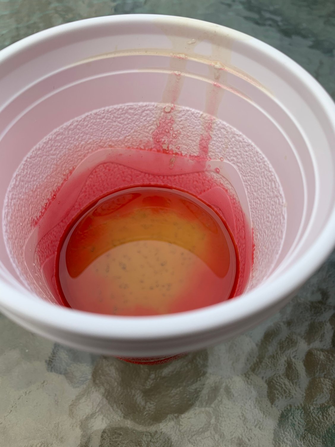

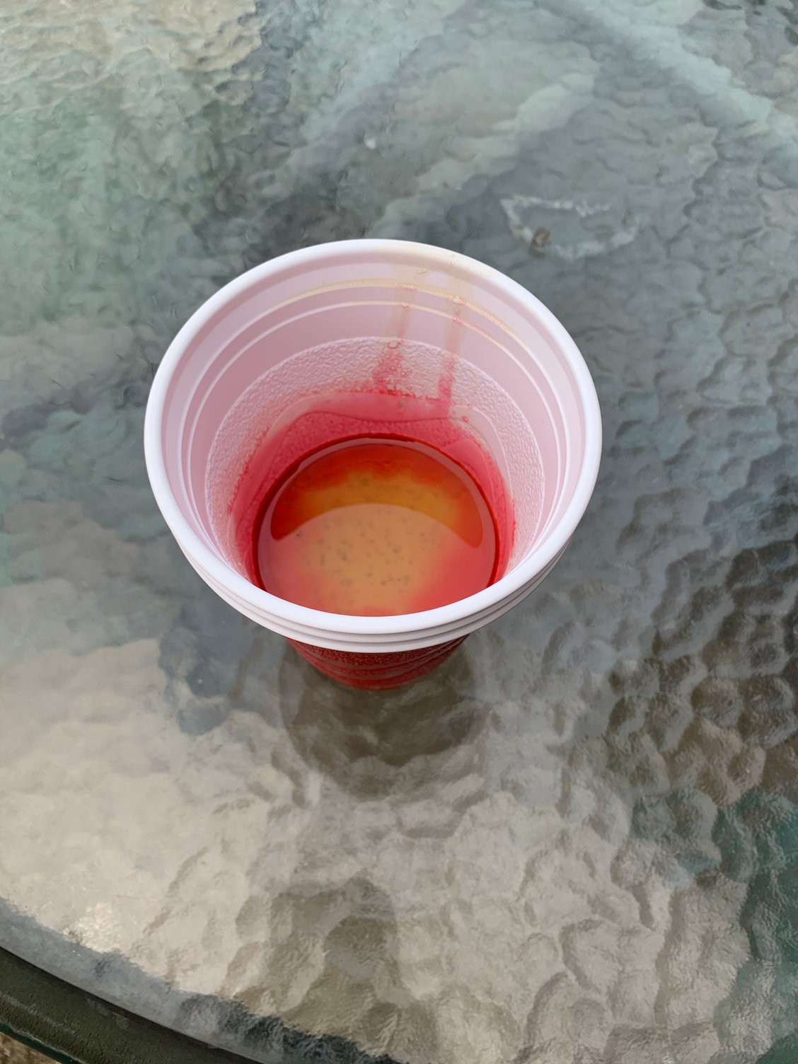

and yes this OCC 100% works. I will drain into glass container next time, gas eats solo cups and I wasn’t even think till it turned red.
It was an oil, gas, water mix that didn’t end up on my intake valves. I have had zero issues with it plugged. Just make sure you have an OCC on other side and check it. I’m a bit **** but I check the oil every fill up and I will be checking my OCC from now on since I’m there, I have a dip stick and it in screws open and closed so isn’t a big deal to do. Have scanguage so I can see vitals, trip from Cincinnati to pigeon forge to see the parents, 4.5 hours driving no issues and I hit 100 a few times threw the mountains. 140,000 on odometer.
