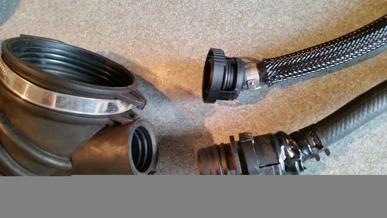

Was the PVC vent pipe redesigned?
I took the intake elbow off to clean the throttle body and broke the PVC vent pipe connector. I was able to cobble it back together. The new one has a different connector. I'm guessing it was redesigned at some point. Do I need to get a new intake elbow too? Sorry for the crappy pick. The new is on the top, old bottom. Thanks for any suggestions.

it looks like the correct part to me.

Looks to me like the old version shows two parts --- hose and union. You should be able to disconnect the union from the old hose and reconnect it to the new hose, then re-assemble.

Would you happen to know the part number for the old union? That's the part that I broke on the hose. Thanks.

oldbrokenwind, please disregard the part number question. I see what you're saying. I didn't think that the hard plastic that connects the hose to the intake elbow would be in 2 pieces. Thanks.

My '07 MCS has a different PCV configuration, so I can't comment on what looks like a "union". Maybe you bought the wrong hose?

Thanks for the link oldbrokenwind. The connector was in two pieces, so I've got it back together.
