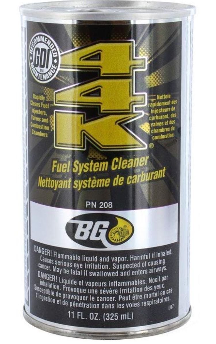

I ordered up some bg44k so I will try at least 2 treatments. While investigating where to get it, I spoke with my local distributor and it’s clear almost all dealers use this stuff....in my area. Hopefully it would for me!!
Just to revive this thread - I did two treatments but the rough or surging on cold start is still there.
Once warm - it disappears.
I think I’ll let the dealer take a look (diagnostic only) as to what the issue is.
