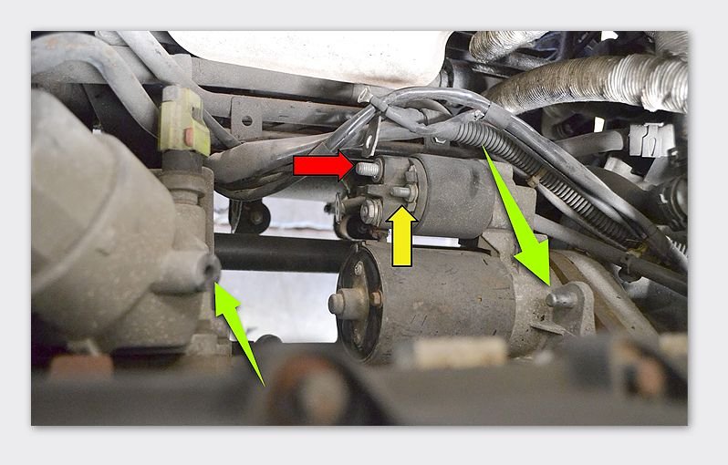

Thanks! Regarding # 6, once that 10 mm bolt is removed can the heat shield itself be moved to permit greater access to some of the bolts on the housing? I have already removed the top heat shield.

Yes, the right (driver's) side of the heat shield has a rubber grommet that interfaces with a short stud that comes off the starter - just above the starter motor. Green arrows show the position of where the 10mm bolt connects to filter housing, and the stud for other end of heat shield.
