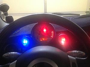

This is the finished project yesterday. I can monitor engine temperature and oil pressure.

Good to hear that you carried out the proper diagnose, and invest in a pressure gauge. Some just want to kill the canary for screaming its head off.
Actually, I just read up on it. The poor bird actually goes quietly in the presence of dangerous gas. A better analogy is to replace the dead canary with one that is more robust, and keep on digging.
