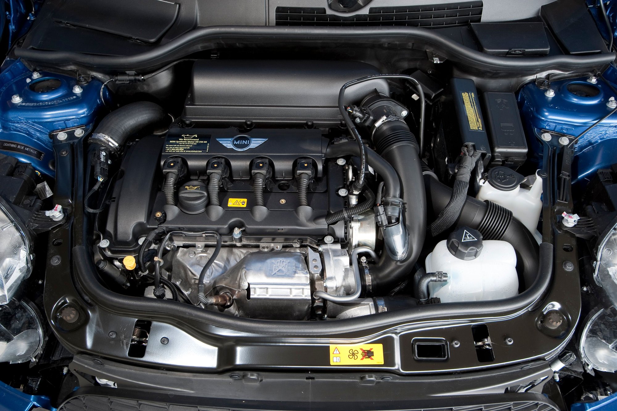

The hood pin or the adjustment stopper will need adjusted, they are rubber and screw up and down.
they are rubber and in the the bottom corner of that U shaped black brace that goes above the radiator with the fan / hand yellow stick.

Adjusting the two stoppers did the trick.... it took about 6 turns each to get it to where the latch works without any issues.
The hood was so tight before that there was NO play at all, even with someone pushing down on the hood. There was so much tension on the hood catches that there was no way they could release.
Sadly, my engine bay looks nothing like that one... my engine is not as clean and my engine looks way more "loved' than that one
Ok,
