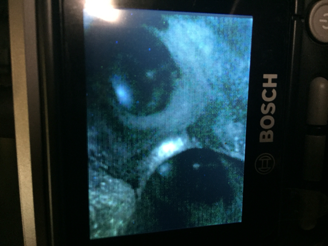

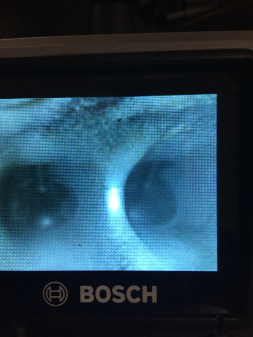

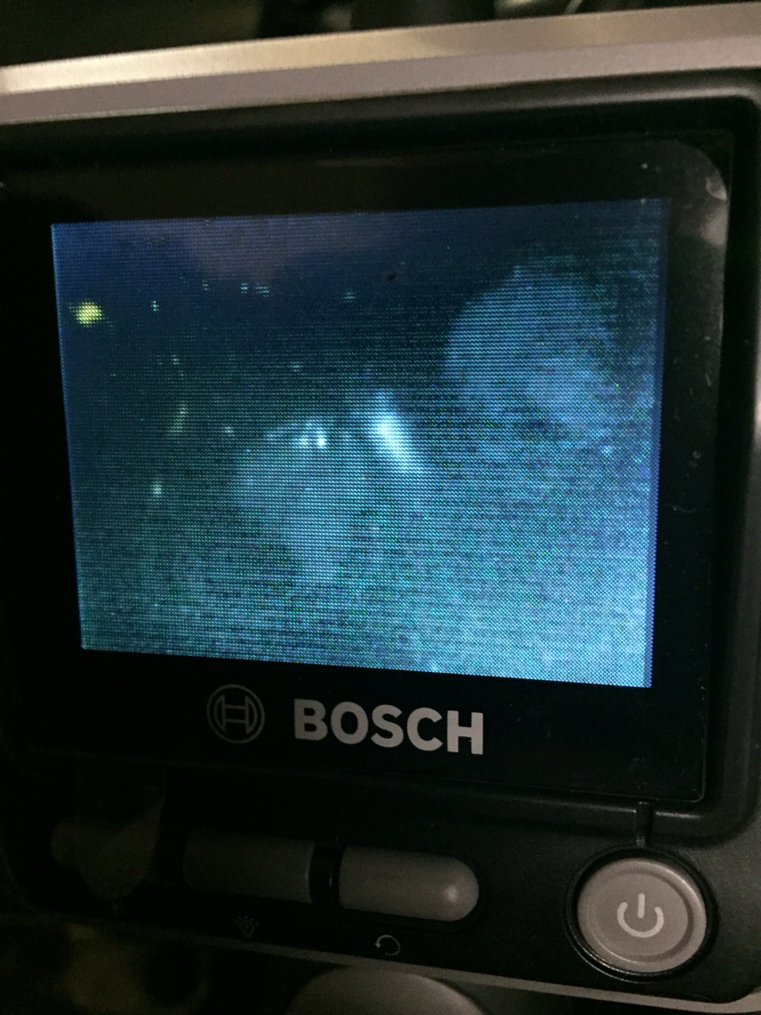

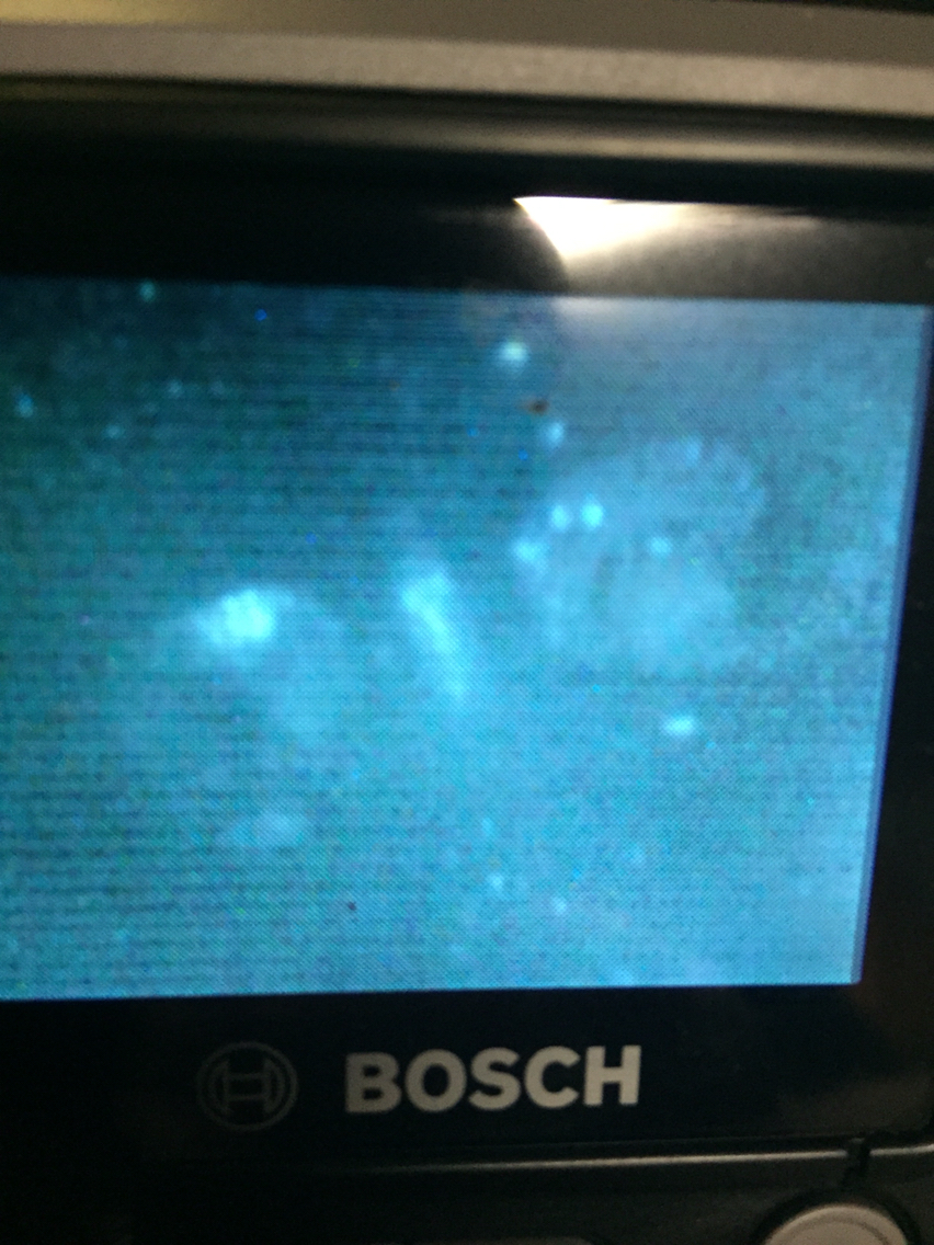

Zee verdict... she is in.
GAT,
The verdict is in... well, actually, it was in on Wed. The HPFP was indeed bad, and MINI replaced that gratis.
Then came the rest of the news - "well - we found a few things wrong"
*gulp*
Short version - valve cover gasket leak, suggested I replace the valve cover as well as it has the PCV valve integrated into it... Upper strut mounts are cracking, replace... and oil filter housing also leaking, replace/repair... Grand total roughly $3k from the dealer.
I asked if there were other issues, what did they think of the state of the engine. We decided to have him pull the valve cover and to see what he timing chain, guides, etc looked like (I've only had this car for about 4k miles, bought with 90k about 6 months ago).
He popped the valve cover off to find that the upper guide was broken, so their suggestion, full timing chain service w/ tensioner, guides, chain, etc... another $2k - $3k depending on if they have to search the oil pan for bits and pieces...
Well - we're closing in fast on what I paid for the car in the first place...
I took it past a well respected local MINI/BMW shop (Terry Slather Motors - great experience there). Their diagnosis was similar, prices better, but still leaves me with a similar predicament.
Not a good prize.
But, it is what it is, and suffice it to say that I've been playing with the MINI builder and I'll prob pull the trigger on a build next week... it has been far too long since I've had a new toy in the garage... well, one that is new as well as new to me. Esp since my job's latest project has me driving 50 miles a day (I was working from the house till about 2 months ago). Have loved this R56, but think an F56 may be in my future.
I guess my only question at this point is too see if there are any suggestions on what all I should do to ensure that the car holds up... I'll keep the oil topped off, ensure that I'm not getting after it too much, and I think I'll source just the top guide and a valve cover gasket; and will DIY that bit of the process. I'd prob do more if I didn't need it as a daily driver... (okay, and if I had the "hold the cam in place specialty tools for the timing chain maint).
Any thoughts from the masses?
Once the new car arrives I'll decide if I'll trade it in or see if someone who is mechanically inclined is interested in buying it (with full disclosure of all I know and have learned). Lots of features (including sport suspension, new tires, new brakes, nav w/ updated 2015 maps, Sirius radio, 6 spd, comfort access...) and other than some peeling clear coat near the mini badge on the rear hatch, the paint and body are in pretty great shape.
Thanks in advance,
- Will
