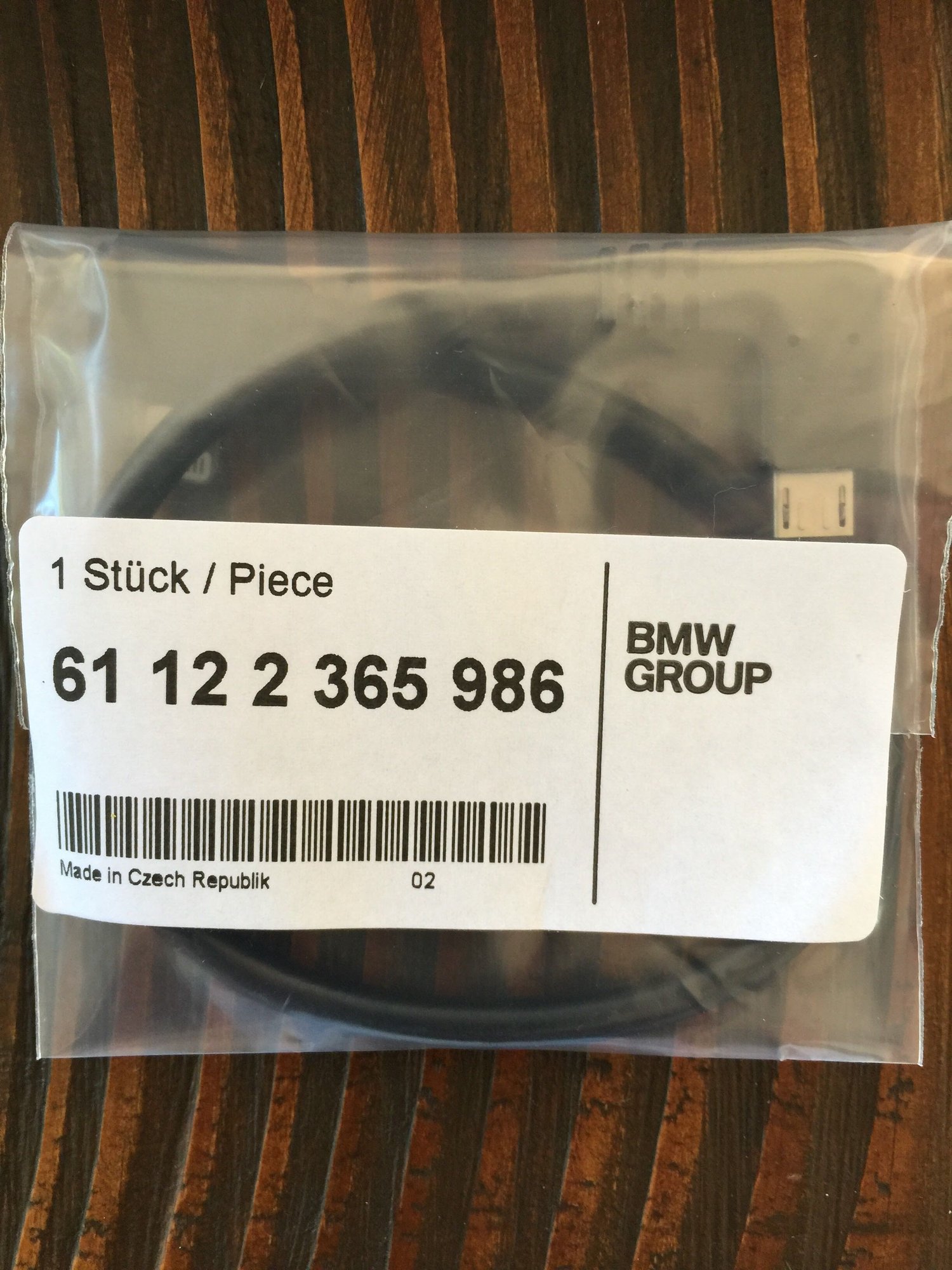

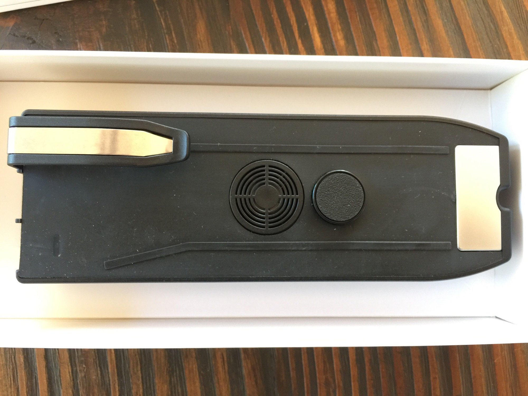

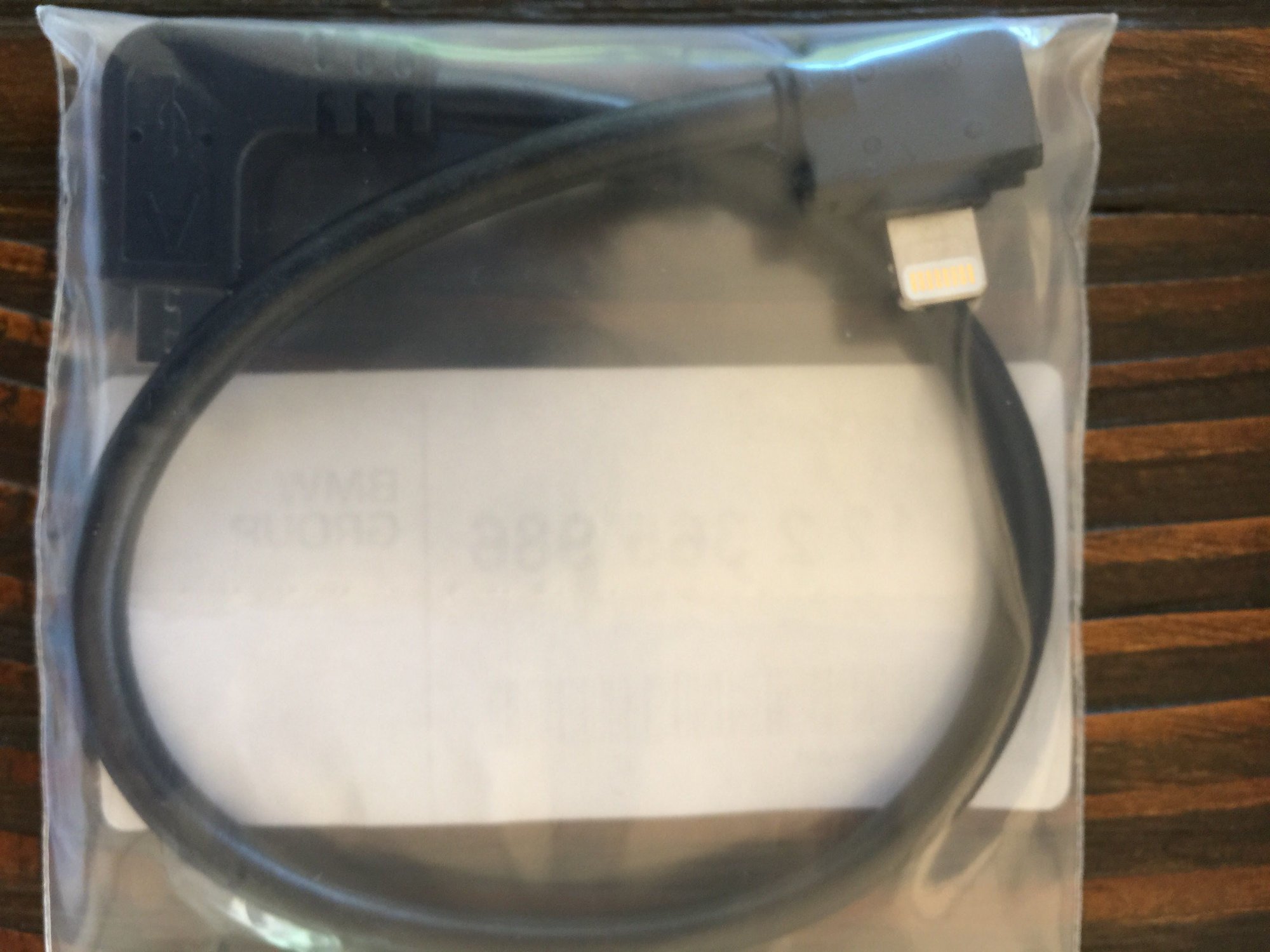

My first unboxing photo share...
I ordered the same item last year from ECSTuning. The package arrived well packed and on time as expected.
After realizing that BMW/Mini hardcoded my 2013 CMS JCW All4 in "analog" with no owner UX access to "flip" the switch to "digital" and with IPhone 6+ usb audio output is in digital...Changed the settings in USB1 and 2 like how the OP described it. Attempted to do the patch myself but the search for a fully compatible dongle was a challenge...that is another story...I utilized another resource person recommended to me with NCSExpert expertise...
I am very surprised BMW have not yet patched this issue which can be easily fixed under 5 minutes...
Been enjoying digital audio the way it should be since we applied the "update" 😊

Sourced from ECSTuning.com...
Ordered by the boss...she made sure that my phone is mounted in the armrest for safety and minimized phone distractions while cruising...
Arrived well packed and works as advertised...
....UNBOXING PHOTOS...
