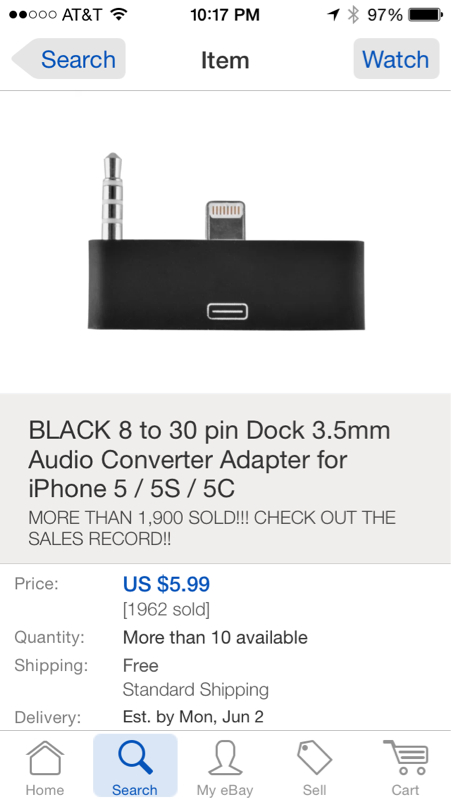

I used a iPhone 5s adapter(8-30 pin 3.5 audio jack) from ebay. Plug it onto OEM MINI y adapter. You do have to hear the sound from iPod/ Aux mode.
Attached Thumbnails Lightening y-cable for 2013 Mini S-image-4227333844.jpg   Lightening y-cable for 2013 Mini S-image-1090697143.jpg   Lightening y-cable for 2013 Mini S-image-1665122599.jpg
Thanks! I'll give this a try. The apple lightening adapter works with the Mini y-cable, but the audio is horrible. Hopefully, this is better.
