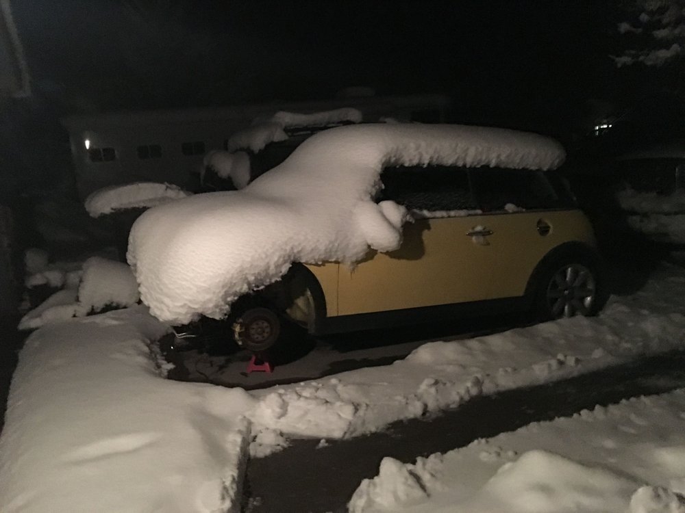

Mother Nature didn't like my plans to work on the mini this weekend. Got in two days of snowboarding instead
Nik

Oh no.... snow problems. Mother nature did not think it was time for the MINI project to be done. She thought you needed time off
