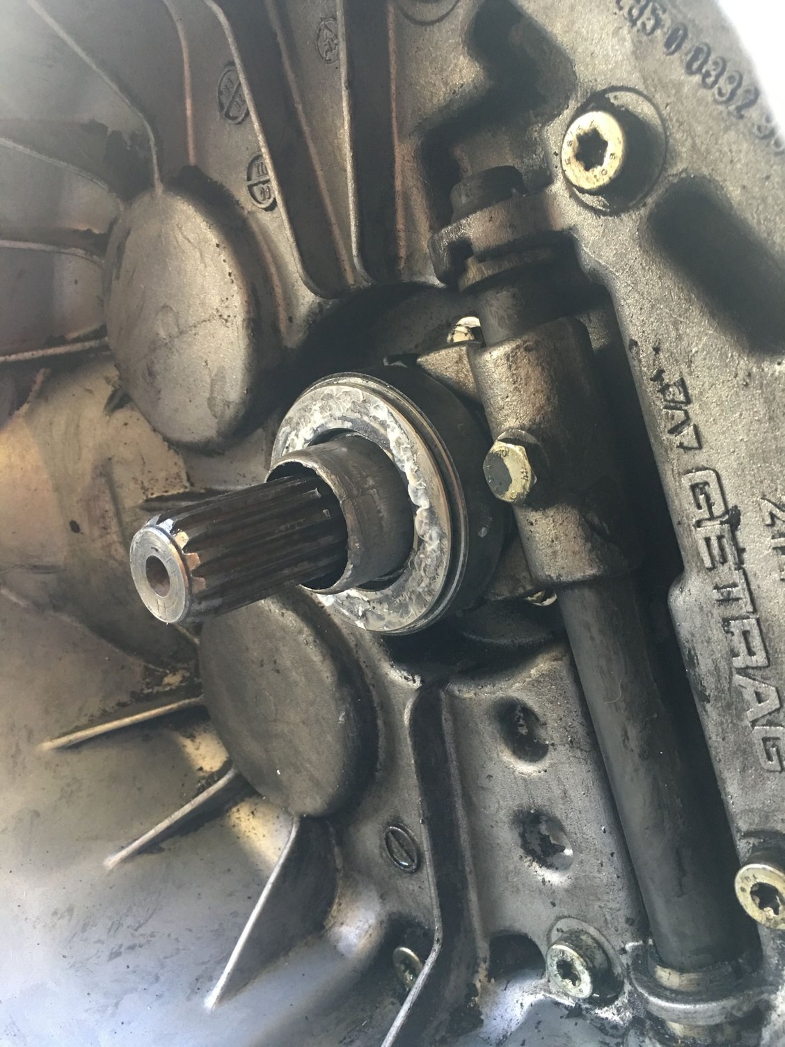

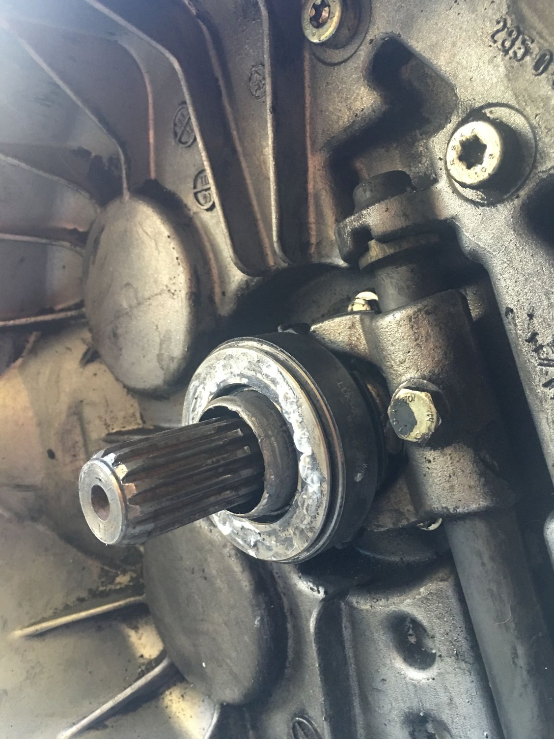

Still haven't figured out the clutch issue. Here are some photos of the inside.
Flywheel, clutch and pressure plate all put together.
Point where throw out bearing should come in contact with pressure plate
Point where throw out bearing actually comes in contact with pressure plate

What is the clutch doing when you have it all together? Is it making noise? You said it doesn't release far enough but does the clutch not engage at all then?
How do you know how far the to bearing should move, and how in the world can you see where it hits with the transmission on?
If you bought all new parts did you compare them to the old ones to verify they are right?
You can't install the pressure plate, flywheel or to bearing the wrong way. So either one of those parts is bad, or something is up with slave cylinder. Does the slave appear to be working correctly?
One other thought. I just watched the video. Is it the moving wheels that concern you? That is normal behavior with the car up in the air. Not all cars do that but I've seen plenty that do.
When it's all together it won't disengage. The peddle goes all the way to the floor, with only resistance at the very end. My clutch w/ 365000 miles worked perfect, slave cylinder and all.
I don't know how far the bearing should move, but I do know where it should be in contact with the pressure plate. I know how far it moved when it was together by the location of the lever on the outside of the transmission. The slave cylinder does not have enough travel to move the pressure plate enough to disengage the clutch, an if it did it would push the thow out completely off the shaft
Shifter arm where throw out bearing should be in contact w/ pressure plate splines
Shifter arm where throw out bearing comes in contact w/ pressure plate splines...

If the pedal goes all the way to the floor it sounds like it's the slave.
Did you disconnect the line to it? If so did you bleed it correctly? Its still possible it could be the slave not working right, even if all you did was take it off. With someone else pushing the pedal, does the slave only move a little bit?
All simple stuff I'm sure you know, but sometimes it's the simple stuff that gets you.
Like I said in my previous post, the parts are wrong or the slave isn't working right. The transmission is the same and the parts don't bolt on wrong. They could be loose but not backwards. Only other part involved is the master cylinder, unlikely it stopped working though.
Good luck xsmini, you'll get it figured out

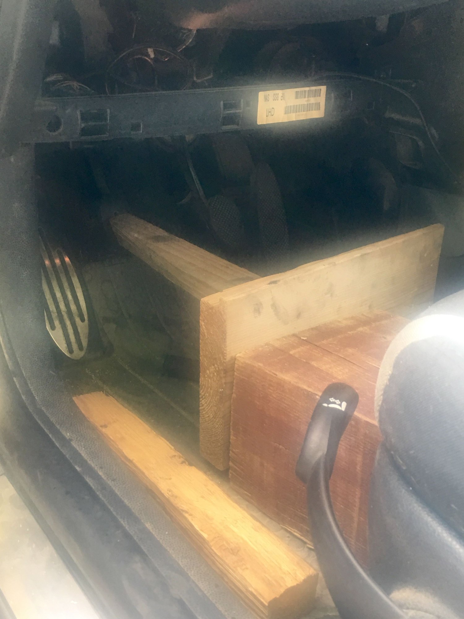

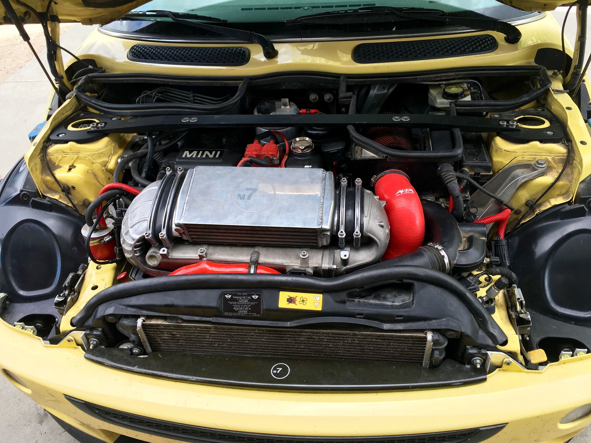

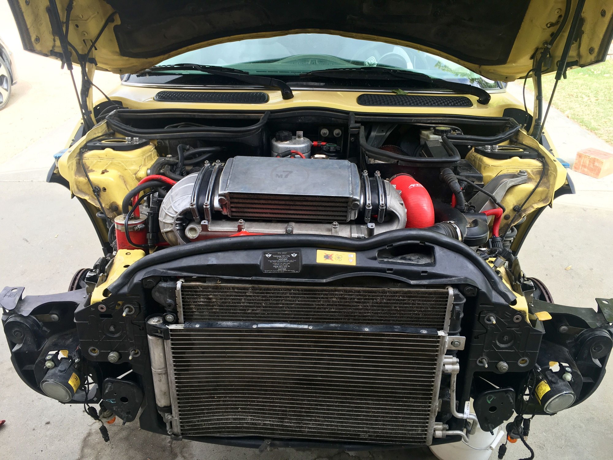

Well finally got everything finished up today. The clutch ended up needing bleeding. I made an assumption on where the throw out bearing was supposed to make contact. Oh well, learned something. So far I have a whopping 3 miles on the new engine, will hopefully find some time to get it out this weekend. Now for photos:
The old bleed the clutch then leave it fully depressed over night trick worked!
Almost done, just bumper, fenders and tires left.
M7 coilovers (someone asked for a pic)
Bumper back on
All back together
Other side
Finally ready for the road after almost three months..... Finally!

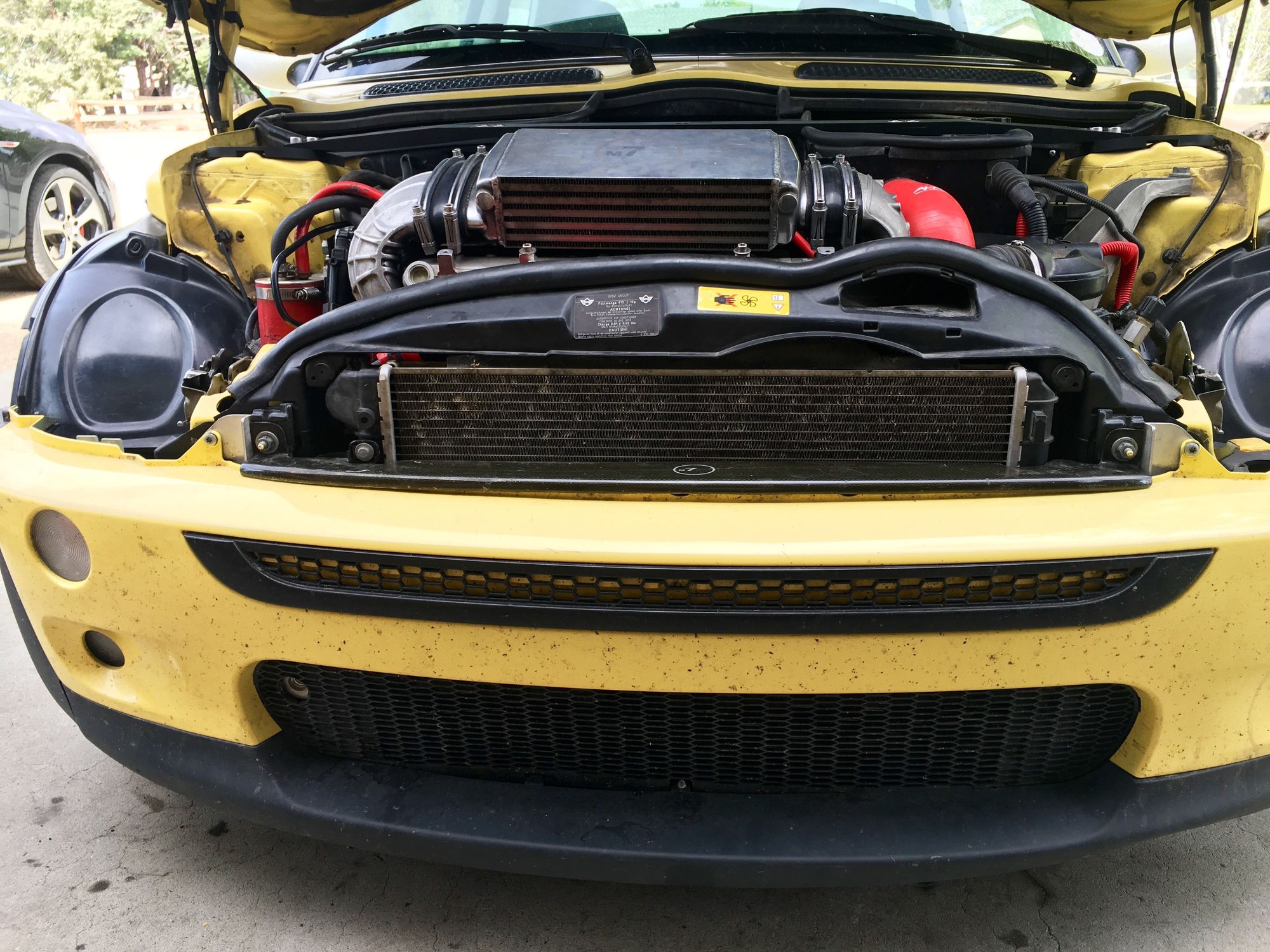

Installed new header today since the old cat was partially blocked. The car is scary fast now!

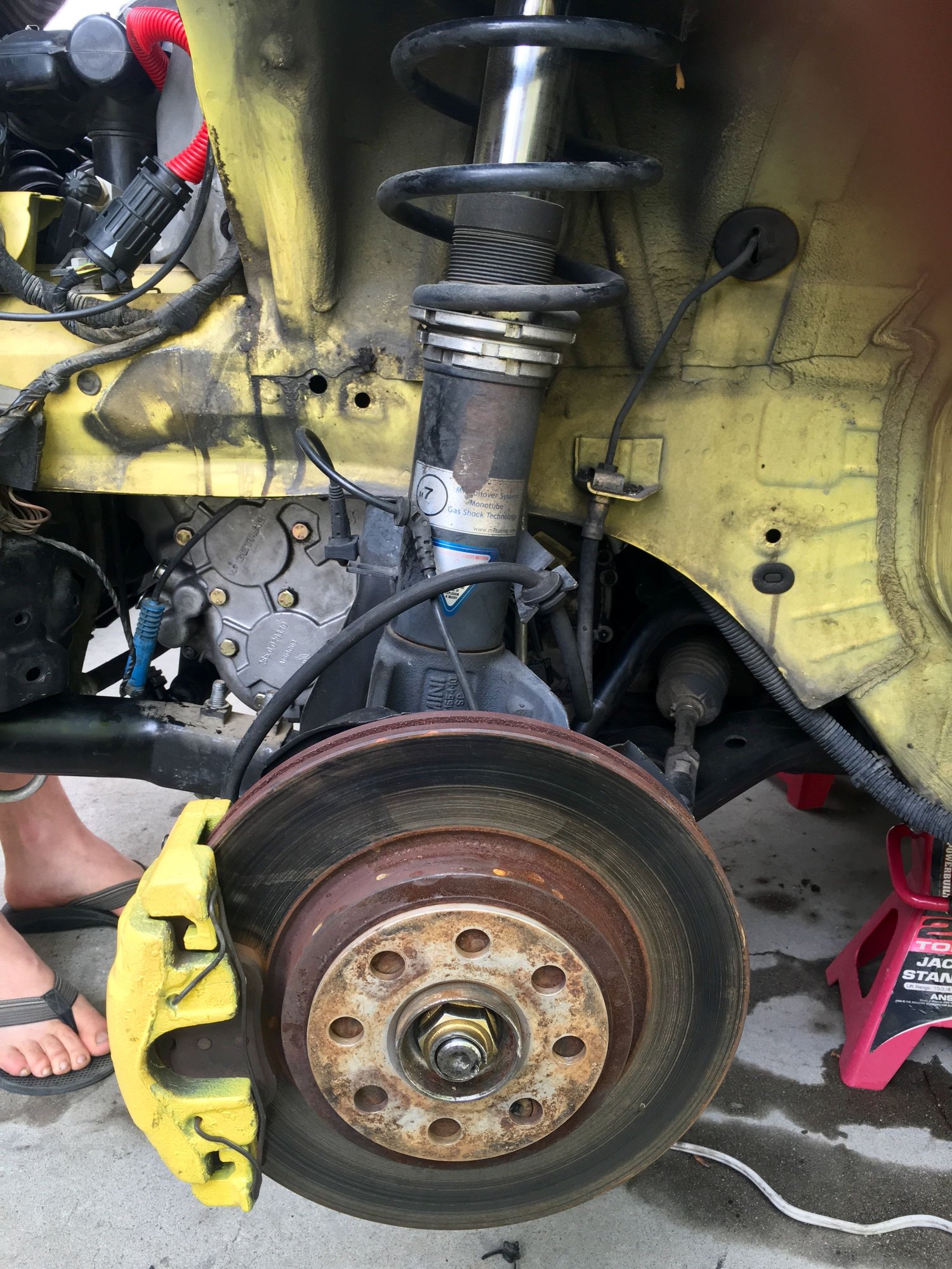

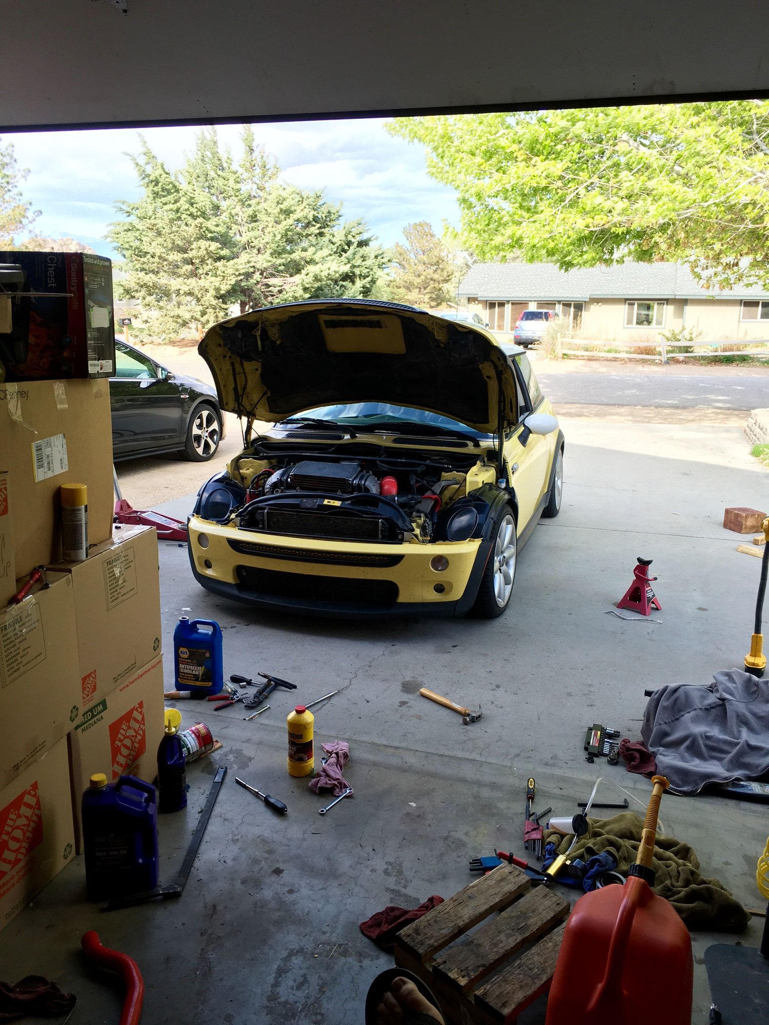

So today I finally finished everything (I think) and changed the oil for the first time with 1550 miles on the new engine. Will be sending off to Blackstone Labs for analysis.
So for the final days work:
Old vs New (and a boxer foot)
Strut out
Shot of the new header from last weekend:
New Header
