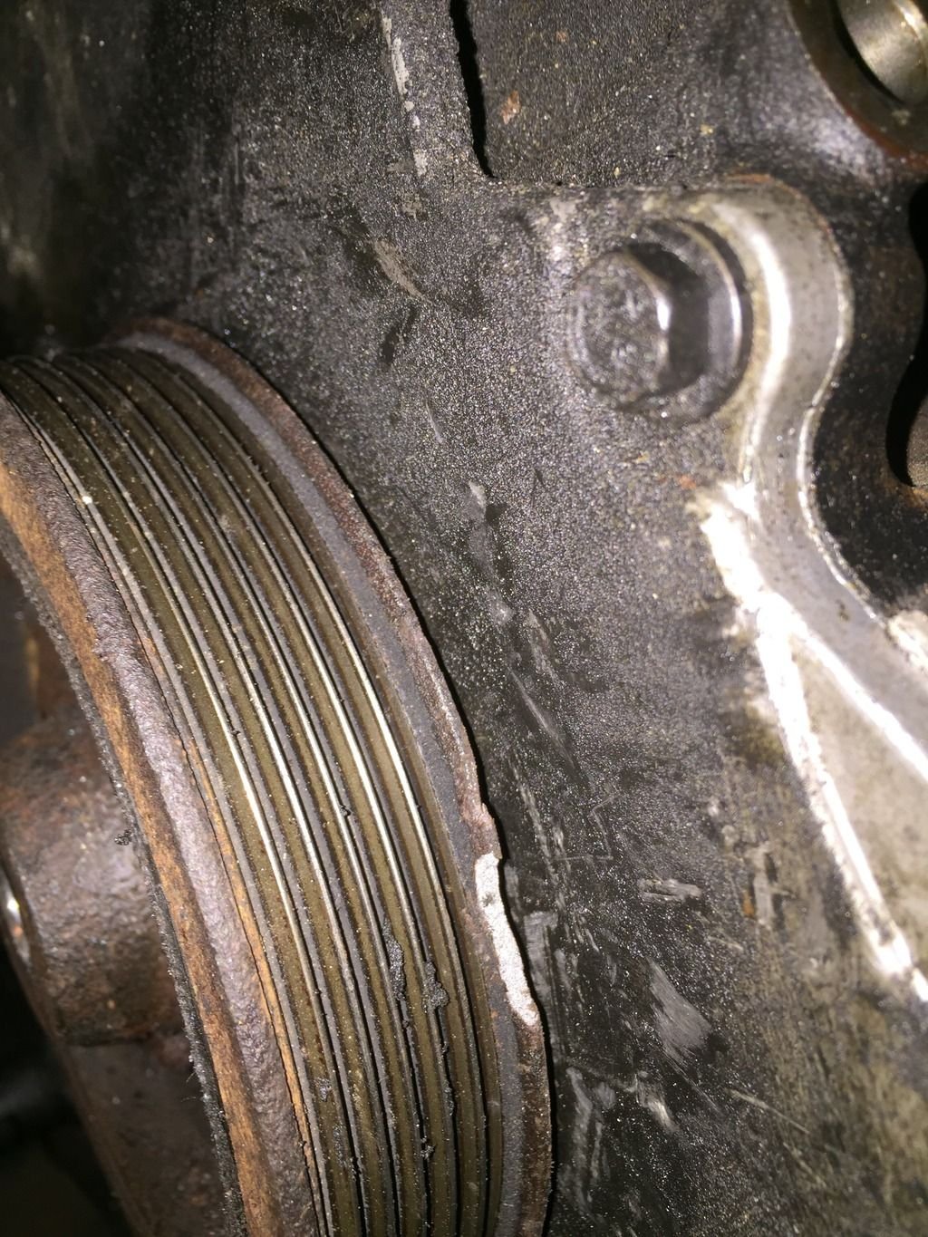

So Im in the middle of my build and Im stuck on removing this crank pulley. From what I read there are suppose to be holes?? I looked at the Pelican Tech articles and ModMini's Youtube Video but mine is totally different.. Am I suppose to just use a 3 Jaw Puller for this one? Any help would be appreciated. Also not sure on the condition of this pulley as well..

I bought a 2 Jaw puller with flat edges .. which i thought would work but THAT TOO Needs some modification to make it work and the pulley is starting to chip off the edges.. FRUSTRATION HAS SET IN!
