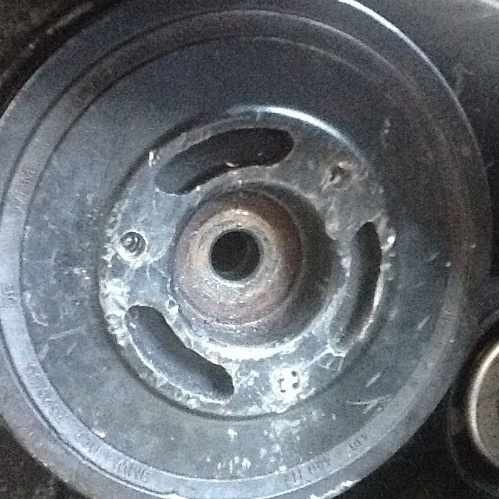

This harmonic balancer is a POS! I retap on screw point then got it working. Next screw point strips out so I start tapping that one and the tap breaks off into the hole. So now I have two useless screw points for the pulley puller! I swear I'm about to loose it. So I guess my only option is to weld the puller to the balancer to remove it. Any other option out there guys?

Show us what's going on, take s couple pics.

Post up a pic of whats going on. I can help you more then just posting links for the DIY

Left hole is good, top right whole stripped, bottom hole tap broken into unit. Aka I'm Fukd.

+1 on the outside with a three jaw and with the long claw. Also hit the center with some PB blaster and on the other side of the pulley between the cover and pulley.
Then have someone tap the side very lightly on the pulley with a hammer to break the friction. .

Also, make sure you're only applying pressure going through the hole of the pulley. When I first tried this, I thought the rusted & polished surfaces (under the mounting bolt head) were where the pulley & crank separated. Nope. Ended up bending some bolts & tearing some washers. I had luck with a couple long headless studs placed down inside where the normal bolt threads are. Once I figured this out it actually came off pretty easily.

To get the tap out, it looks like it's a 3 flute hobby type. Take a couple small picks, put them in the holes and put a screw driver between then and gently wiggle back and forth. It's a finesse thing. Gotta do it gently. Just wiggle it back and forth to get it to move the try back it out. Then back in. The back out. It's gonna take time. Once it's out far enough grab it with vice grips. Be very gentle.

Hey, Are you placing the pulley adj bolt on to the pulley itself or on an extension balancer pulley bolt. Go to the Pelican.com website to review the procedure. The pulley must be pushing against the extension bolt so that the balancer can be removed otherwise you are just pushing against balancer and doing nothing except bending the "sh*t" out of it.

No I have a bolt extension going down the center of the puller and pulley.
