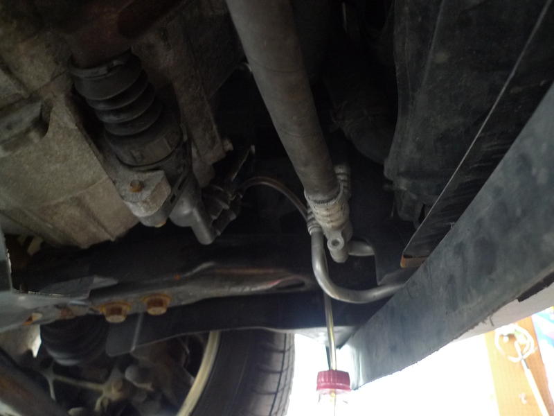

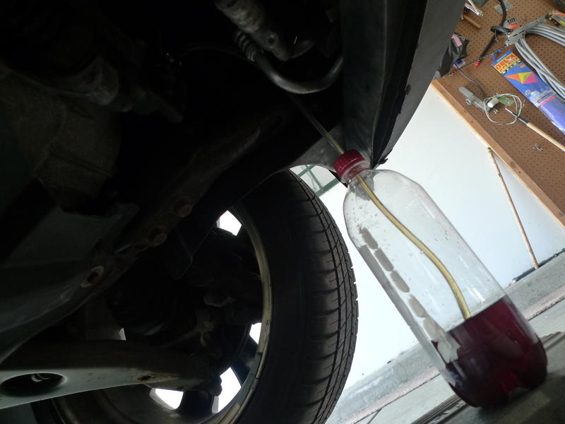

I've been slowly but surely fixing this.
First, replacing the lower motor mount bolt really helped with getting it into gear.
Next, flushed the clutch fluid and has made the clutch pedal a lot easier to press!
This little plastic thing in the shifter is next on my hit list:
https://www.northamericanmotoring.co...ifter-now.html
Attached Thumbnails Difficult shifts-p1060099.jpg   Difficult shifts-p1060098.jpg
