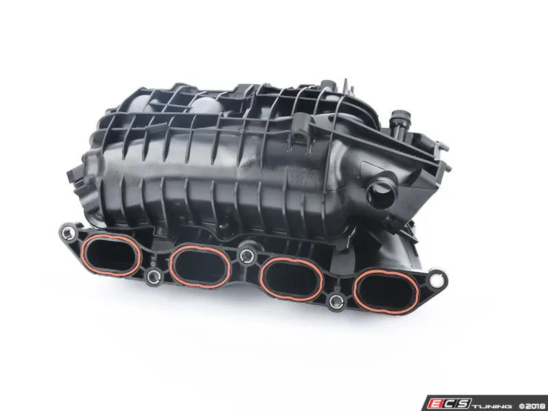

https://www.realoem.com/bmw/enUS/showparts?id=MF33-USA-02-2008-R56-Mini-Cooper&diagId=11_3915
Cooper (base) intake manifold 11617604597

Any suggestions how to push the bayonet connector on the intake manifold to get it to release (in the 1st photo).
I can barely get my fingers along the hose to get to even touch the connector.
Old Feb 22, 2019 | 10:48 AM
Posts: 36,762
Likes: 2,552
Get some with a small hand or take off the intake pipe and then try to reach under with your left hand maybe, its a hard location. Might need to get a long pair of pliers that are bent to reach under and pinch the tabs.

It is not possible to replace the hose on a normally aspirated gen II mini ('09 specifically).
The intake manifold must be removed, the pcv hose disconnected from under the manifold, and then replaced, followed be reinsertion of the intake manifold.
One cannot compress the fitting and pull it /pry it up, nor press it back on with sufficient force to put the connector back on the intake manifold, with the manifold on the car.
This thread shows it can be done with a cooper S, since the pcv hose exits the manifold and connects on the driver side, external to the manifold.
