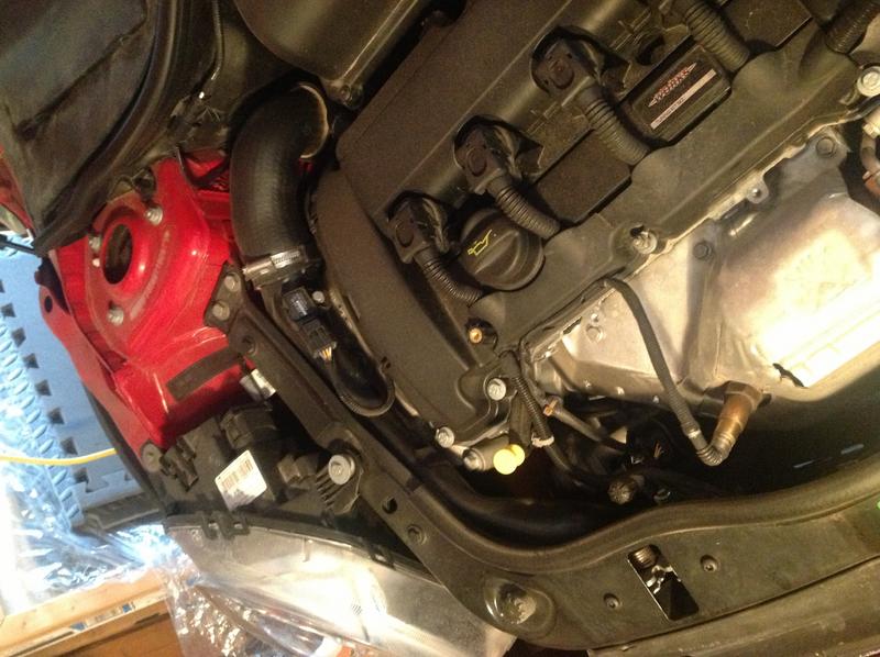

Got it apart. Aside from the cold air hose there are several plastic tangs that fit into rubber grommets. After inspecting it the fault could have been one of two issues. Since I fixed both and the noise is gone I'm not sure which one it was or a combination.
First the photo shows what I guess is the heater connection. It was loose and not snapped in. Not sure if this happened when I took the box out but the heater had a bad smell prior to that and if that's what it is it would've been getting air from the engine externally. I did my best to snap it back in although its not a strong 'snap' into place.
The other is the screw holding the left side of the box to the plastic bottom. Since the screw just turned like it stripped I put a rubber spaced in there and tightened it as secure as possible.
Hopefully the noise won't come back. Thanks for the help.
PS: Don't know why the photo is up side down.

That's the noisemaker, it takes boost air and runs it through a resonator and then into the firewall. It is supposed to provide a sound to enhance the driving experience of the r56 mini. Mine also popped off on my 2007s when I had it. A couple of the tabs had broke. I found a replacement at mini of south atlanta ( they have an online parts dept). It's a piece of cake to replace. You also may want to check all the connections to the boost tubes from the hard plastic line that comes off the inter cooler. I had some oil leaking from mine from blow by comming from the turbo
