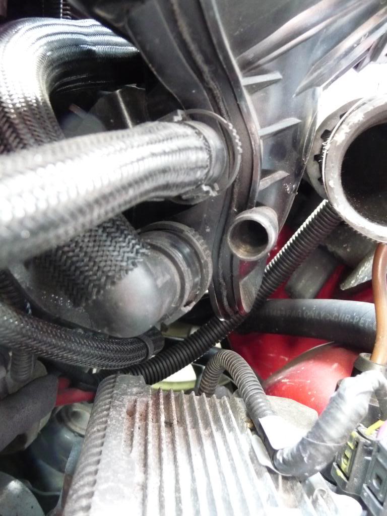

Now i'm sure most if not all of you are aware of the issue attaining to the N14 engine, which has the issue of excessive carbon build up on the inlet valves ?
The usual method is to fit an oil catch can or use a cleaning additive such as Seafoam, BG K44 etc etc or maybe both, there has been discussions and I have mentioned this too, about the fitment of water/meth injection to help remove and control the excessive carbon build up.

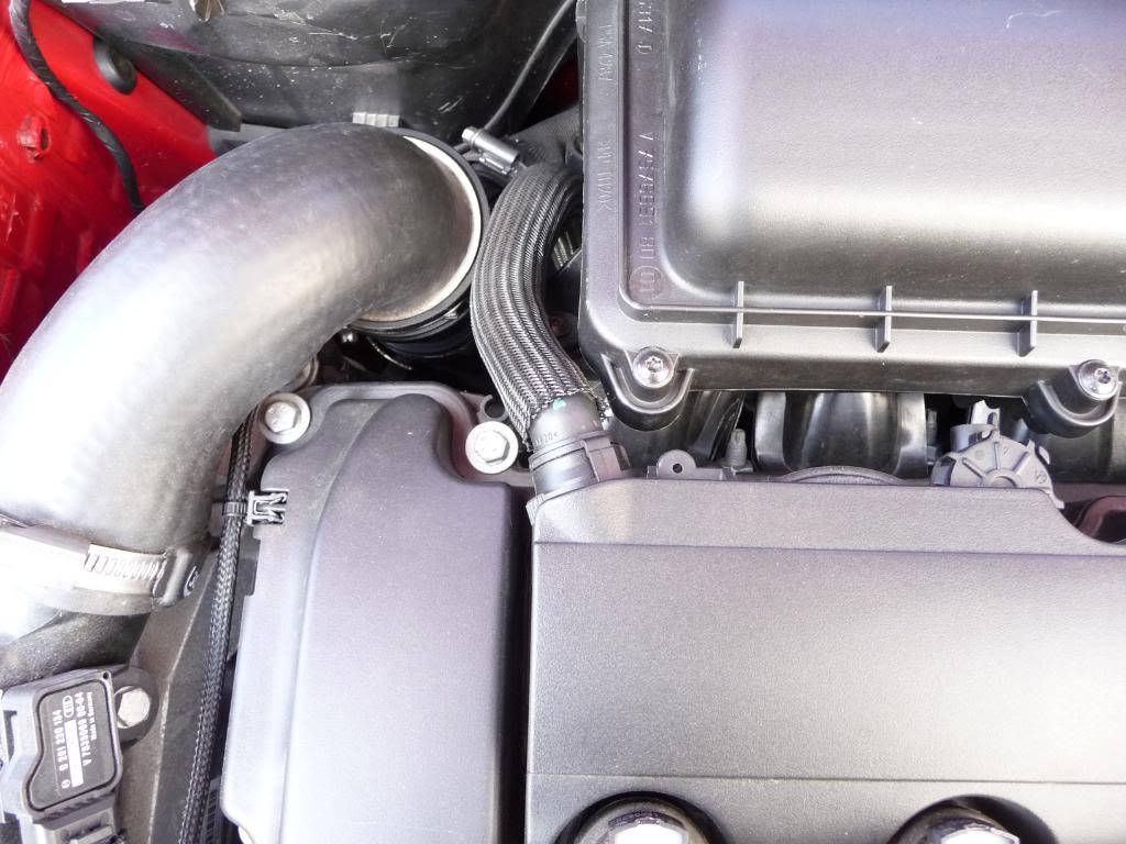

For a while now I have been testing another solution, and this is to completely remove the rear PCV hose, which feeds the crankcase gas oil mist residue directly into the base of the inlet manifold, which in turn is pulled up into the incoming air flow and finds itself being burnt onto the inlet valves.
So the following photo's show what I have done as another alternative to combat this issue.

And all is well and good.

very interesting, where did you find the caps to replace the hose?

The BSH Dual boost tap does the same thing, though it leaves the hose in place. Be sure you put an oil catch can on the hose going from the driver's side of the head cover to the turbo inlet, because all the oil vapor will be going into the turbocharger and then into the intercooler without the PCV hose.

This guy is dead on. However removing the intake manifold line is really only half of the equation.
Now that the intake manifold line is blocked off, Instead of running vapors from your can to your intake boot, you can just run a vent off of your can. This way virtually all of the disgusting blow by is directed in to your can. Normally this wouldn't work because the air would have to be monitored and running a vent would induce a massive vacuum leak. buuuttt..... youve deleted the vacuum so its all gray. simply take your BSH port that is running to your intake boot and put a filter on it. (dont forget to block off the boot)
P.S. as an added bonus by deleting your intake pcv port you have a spare 12 heater or power souce available. you can use this to do all sorts of things. but ill save that for another topic

So I installed a OCC on the passenger side line. One thing I would like to know is, where is the PCV valve located? Is it in the valve cover or the inlet manifold? Because I found nothing in the hose that joins the two. The reason I ask is because if it's in the Valve cover I will have to put one just outside the inlet manifold to avoid pressurizing my OCC (and Boost loss from the extra hose length)
By the way, it is a major PITA adapting hoses to the factory hose. I used a 5/8"ID hose and fittings, but the factory one is corrugated and more like half way between 5/8" and 3/4". I eventually found some adapters and used instant gasket to make sure there were no leaks.

I haven't cut one open yet to get a full view, but there is basically a plastic flap just inside the hole of both the driver and passenger side breather pipes. These look to open and close in the same way a traditional ball/spring PCV does.
They both gather crank case gasses from about the middle of the valve cover through a hole roughly .75 x 1.5 inch.

Although the caps are a relatively good idea, I personally would NOT recommend this idea on the track, as the crankcase pressures are far different from regular street driving!
for the track you want to evacuate crankcase pressure efficiently and quickly, and so I adapted a completely different method, I still capped off the inlet when using the stock inlet manifold, although now I use my bespoke Aluminum inlet manifold!
