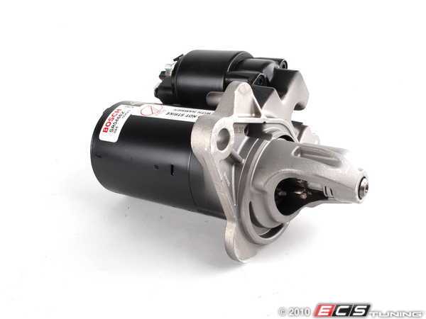

Sounds like the starter. It must have turned "stuck on" the and keep running up against the flywheel, then shorted out. Blowing the fuse. Usually when a starter goes bad it just stops working.
Starter part number 12417570488
