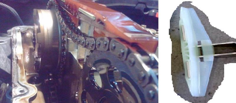

Here is a pic of my cam chain. For someone who knows, does this look right?
I'm right in the middle of installing a new valve cover gasket, cleaning out my intercooler pipes, and blasting the intake ports with some walnut action.
Before I head over to the dealer to get the gasket, I'm wondering if I should get the longer chain tensioner.
Thank you.

You definately need to check the guides and tensioner. You should not have that much slack.

What can I check? I was going to rotate the engine and watch the chain on the tensioner.

Just from your pics you can see there is no tension on the chain. Were you experiencing any noise? Check out this thread

You definitely need to check the guides and tensioner. You should not have that much slack.
I rotated the engine through a few rotations via the crank pulley. The chain tightened nicely and stayed tight after I re-torqued the tensioner bolt..

Uh, that/your upper guide looks to be damaged. Look @ the below picture...see how the lower section of the upper guide has little tabs that extend all the way to the aluminum mounting arm, yours aren't there and are probably floating in your oil pan. Yo chain be slappin' hard. :O

I see what you mean, the guide seems to be the same length but there is some material missing in the middle of the guide that keeps the chain off the metal support?

Those tabs that your upper guide is missing is a good indication that your chain is far beyond saving in terms of stretch/deflection. Throwing a longer (updated) tensioner @ this current timing chain will only band aid your problem. To be honest i'd really think about replacing your timing chain assembly ASAP. I have seen these chains stretch enough to make contact with the physical aluminum arm which in turn will snap the chain...and from there you can imagine the catastrophe to come.

The cam chain measured 72.7mm to tight, 72mm is max. See the solution in this thread:
