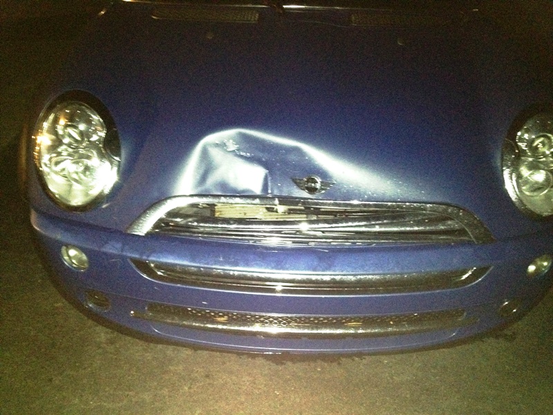

I have a 2005 Mini Cooper Convertible which I bought brand new...no issues at all ever, except the occasional repair on minor things here and there. I DRIVE MY CAR...everyday!!!! I LOVE THIS CAR!!!!!
Right before Christmas, I hit a deer at about 45mph. It damaged the hood, broke the radiator (all the fluid leaked out), and in total did about $5,300 in damages. I have always carried full coverage on it, even though the car has been paid off for quite some time because I never wanted to take a chance on losing my favorite car of all time!!!!!!
Well...I finally got the car back from being "fixed" a month after the accident. It was only worked on by a body shop...never seen by a mechanic, but I didn't realize this was an issue until later. A couple of days after I got the car back, it was making a squeeling noise from under the hood that I had not heard before. I told my husband about the sound, and he diagnosed it to be the powersteering fluid. We replaced the powersteering fluid with the correct stuff that should have been in it before (come to find out, the body shop had put a different fluid in) and anyway, the noise didn't stop. It not only got worse, but the steering went out completely! A few days after the sounds, the steering wheel would NOT TURN AT ALL!!!!!!!!!!! I parked the car, and my husband again started trying to fix the car even though I insisted it had to be related to hitting the deer.
He then decided the power steering pump was going out--the noise was coming from the pump. We arranged to purchase a pump to replace the one that is bad...in the meantime more ps fluid and about a 5 minute resting period for the car would result in the steering wheel turning again. This happened again on Wednesday, Feb. 8th 2012--powersteering gone...NO TURNING THE WHEEL!!! I sat in the parking lot for a few minutes so it could come back. Then went on my way. The next day I ran an errand from work and got back to my car...it would NOT START!!!!!!!!!
The engine turns over and over, but never fires off. It appeared to have gas (according to the range indicator) but after thinking about it for a little bit, it had been displaying the SAME NUMBER FOR THE ENTIRE DAY!!!! So, I don't know how much gas it actually had! We put gas in it, and tried to start the car...AND STILL NO GO!
My big question here is this...IS THERE ANYBODY OUT THERE WHO KNOWS HOW IN THE WORLD THIS COULD BE RELATED TO MY HAVING HIT THE DEER AND/OR THE REPAIRS THAT WERE MADE TO MY MINI!?!?!?!?

I would have it towed to a Mini Dealer and have them fix it. But first I would call my insurance company and try to reopen the accident case if it has been closed. The problem you are having now could be related but without expert advice it's going to be difficult to prove it.

I'd get the car to either a dealer or a well trusted MINI shop to see if where there may be some electrical shorts.
Nothing against any body shop, but often they aren't up to date when it come to all the new electronics in cars.

Sounds like the P/S problem may be related- maybe not directly but, because of the procedures the shop took while doing the collision work. If there was P/S fluid missing, it had to have leaked out ether because something was damaged in the accident or durring the repair process. Call the insurance co, tell them about the problems and that you suspect the issues are loss related. Tell them you are taking the car to a mechanic (not a body man) to have it checked out. Most insurance co's have what is known as a "tear down policy". You autherize a mechanic to diagnose by doing the "tear down". If the problem can be determined it is loss related, they will pay the "tear down" cost and what it will take to fix it. If it's not loss related, you are responsible for the "tear down" cost and the repair. That's fair for everyone. By the way, your insurance co did not do the repairs on your car, the shop you chose did. All your insurance co did was pay the bill.
Power steering issues could be a bubble in the line, but could also be not enough power getting to the motor (broken power cable somewhere? fuse blown but not completely?)
The fuel issue could be debris in the line or fouled pumps. This could have been contaminated from the collision with the deer.
Both cases, you most likely will have to prove it was directly related to the accident (the fuel you can probably get there, but the power steering, most likely not). Even if you can prove it, you'll most likely have to fill out forms for reimbursement for the fixes, and you won't be covered on all you've done (and still have to take it to an approved shop to have inspected).

When you get "bad gas," this is what causes it. Gummed fuel pumps/lines from some contaminant in the fuel. It also doesn't have to happen immediately. Some pieces will just float to the bottom and not budge until next refill or until something causes a sudden jarring motion.
