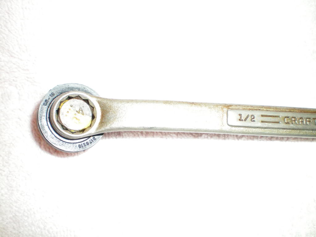

you can search for my earlier posts on this issue but the executive summary is this. Take a new unmessed plug and you'll find the recommended size metric is a sloppy fit. The metric is a tad too big. Use a sloppy 12 point socket and you can trash the head even if the bung isn't over torq'd.
Using a 6 point socket helps but the fit is still sloppy. I now use a 1/2 inch and if the bung isn't already messed up no longer have problems. Do the math....the 1/2 inch is a TAD smaller. I also believe that built on plastic washer becomes a problem with re-use. Haynes says replace the entire plug everytime . . . btw this poor sizing is also a factor in getting an extractor to fit tight meaning you may have to size down and pound a bit more. A too large extractor is just going to shave even more off the head b4 you get enuf grip to apply torq'

.The 1/2 socket works much better to on the OEM plug...nice and snug..does not round off the edges either!! It has been my trick too since 05' when i first realized it fir better!!
