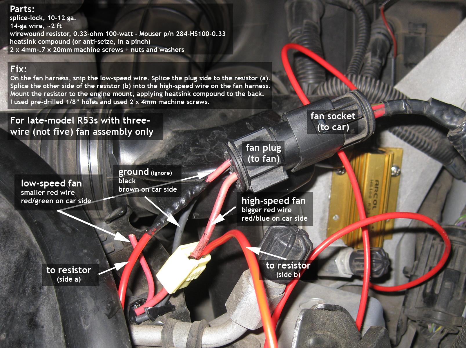

cool, ordered now. if anybody has a "how to" for the Arcol part pictured in post #30 and specified above, much obliged.
Old Aug 23, 2013 | 12:17 PM
  #35
JRhea's Avatar
JRhea
Joined: Sep 2006
Posts: 227
From: Orlando FL
Regarding a how to. When you remove the fan shroud assembly you will need to cut the tabs off on both sides of the green resistor and throw away the old resistor.. Then I improvised and turned the metal tabs into the male end of a "spade connector" I made up 2 extra heavy (14-16 gauge??) braided lines and put female spade connectors on both ends of the two lines and simply plugged them in to the fan leads and the resistor leads. As you can see in the photos I coiled up the extra line and zip tied below the resistor.
Note at the fan side you could as easily splice into the wires. I used spade connectors to make replacements a breeze. Turns out the resistor is heavy enough to outlast the car so a quick disconnect is a waste of time.

it can be connected much more elegantly, but this clearly shows the "how to" connect the replacement resistor w/o removing anything: https://www.northamericanmotoring.co...1-post867.html

Thanks for all the info. I cant tell which side of the resistor is A or B? Does it matter? It looks like the wire from the low speed fan wire goes to the "bottom" of the resistor as it's pictured. and the high speed the "top". But the pictures cut off so I'm not sure. Thanks for the help.
Old Apr 22, 2014 | 08:34 PM
  #39
PrplPplEtr's Avatar
PrplPplEtr
Joined: Mar 2006
Posts: 647
From: Indy
Doesn't matter.
