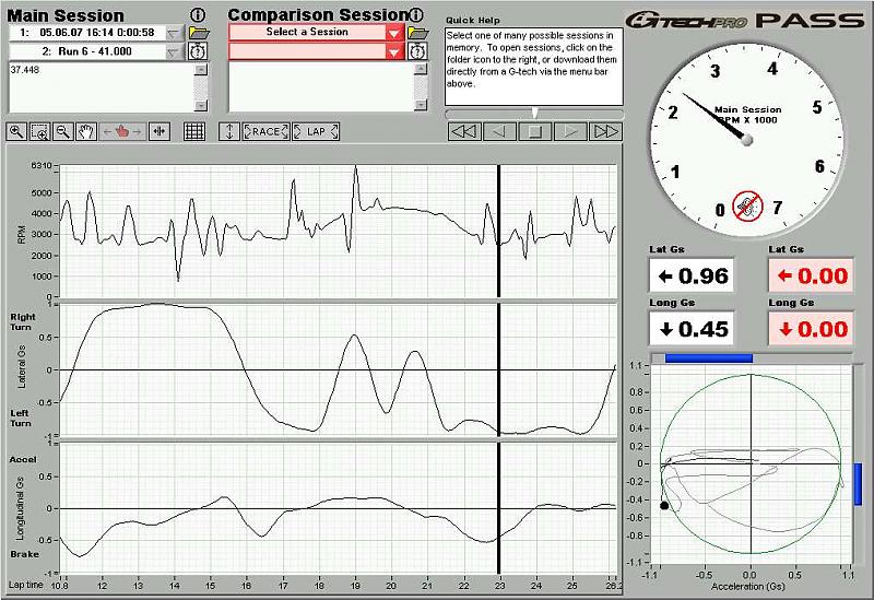

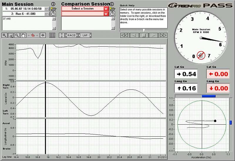

more data
Regional Solo up in New Hampshire - 60 degrees and dry - tire temps never reached 110 degrees
Attached Thumbnails 225/45-15 shaved Hankooks work-fastslalom_morethanaturnpersecond.jpg   225/45-15 shaved Hankooks work-trailbrakingleft.jpg   225/45-15 shaved Hankooks work-trailbrakingright.jpg
