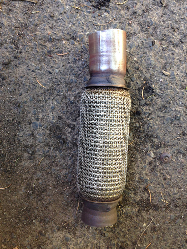

Originally Posted by bmwr606
the major restriction is the stock flex pipe it is between 1-7/8 to 2 inch id any exhaust mods that do not replace the stock flex pipe may make a nice sound, but dio not expect any power
Indeed! Mine measured 1.75" at both pinchs!! I just replaced the flex with a 2.25" braided flex. No more restrictions on the exhaust now. Out with the old and in with the new.
Attached Thumbnails Resonator and 2nd Cat Delete - CM4-image-2157329969.jpg   Resonator and 2nd Cat Delete - CM4-image-3229020336.jpg   Resonator and 2nd Cat Delete - CM4-image-4128677057.jpg
1.75" OUCH! my milltek DP back exhaust measured at 2.5" ID before I installed it
