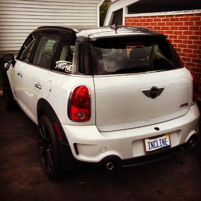

I jumped on the Burger Tuning JB+ in an effort to preserve my warranty for the last 20,000 miles. After that, I might have to go for the FMIC. The JB+ arrives on Friday. I think the extra boost will be a nice complement to my lightly modded exhaust and air intake.
I can't recommend the RU-1540 air filter and resonator and 2nd cat delete enough. A great improvement in sound and a small bump in performance for about $100. We'll see if the JB+ makes a difference. My best mod still might be my big sticky tires though.
