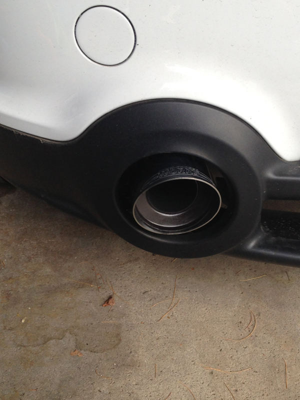

Took me a min. To find brushable high temp paint, but love the results

Some powders will hold some heat. Not sure what the tips heat up to.
The issue with powders is it needs to be cured in an oven @350'F. Obviously not an option once installed. The other option is to apply a ceramic coating...somewhat limited to colors and finishes, blacks, silvers, light texture, smooth. These are actually a wet spray and can be heat cured or air dryed with same results.
Ceramic/Cerakote is an excellent product, we have applied this to hundreds of applications from bike pipes, exhaust manifolds, headers, even fire pit screens and grills. Most will hold a constant 1600-1800'F. ppw4services.com

no I'm very happy with how mine came out, and only cost about $15 in paint, despite the fact I have a TON of extra paint now haha
