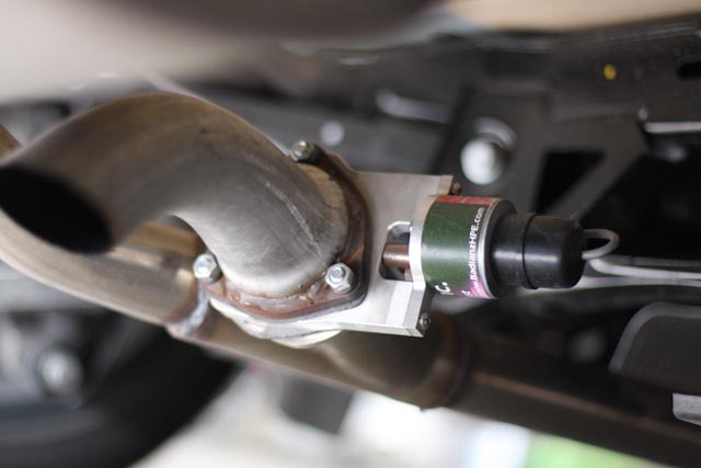

Lastly, the cutout was positioned to be 1" before the muffler - this gave plenty of ground clearance, and ensured that the exhaust gases would be vented out properly, and not toward the cabin, gas tank, or wiring. You can see the finished cutout in the earlier picture.

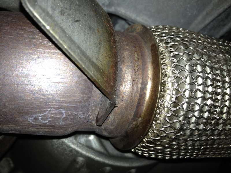

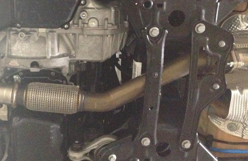

Can you confirm what the diameter is of the pipe from the flex joint to right before the second cat? Basically, the area between the DP and the flange on the far right of the attached photo?
I know the mouth of the DP is 2.5" and it necks down to not much above 2.0." The question is where? I'm hoping it's after the flange on the right, but I'm doubtful.
Also, the second photo is another possibility for dual mufflers in the rear.

From the Flex Joint to the 2nd Cat is 2.25" give or take. And it only gets smaller from there...
You're correct about the 2.5" from the DP, though.
EDIT: For the record, that front engine/exhaust part looks different than mine...

Thanks for the prompt reply. That's what I thought; 2.25". Too bad. I think the difference between yours and mine is because mine is just an "S," no All4.

I saw that from the rear axle. I can't really say for 100% certain that yours isn't 2.5" -- but in my case, the flex back was only 2.25".
I hope to remedy that shortly.

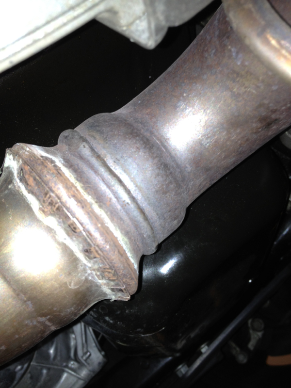

Wow - that's awesome. Mine is for sure necked down to 2.25 in 4 places. Staring at the pipe literally right this second. Will take a pic.

Pics
