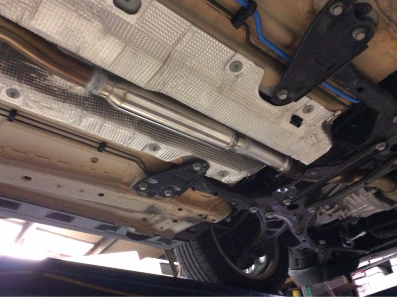

At the exhaust shop this morning. Figured I'd post some before pics. Plenty of room at the back of my non-All4 CM.

And the after shots. Initial impressions are almost stock sound with cutout closed and nice tone with lots of pop and burble with it open.
