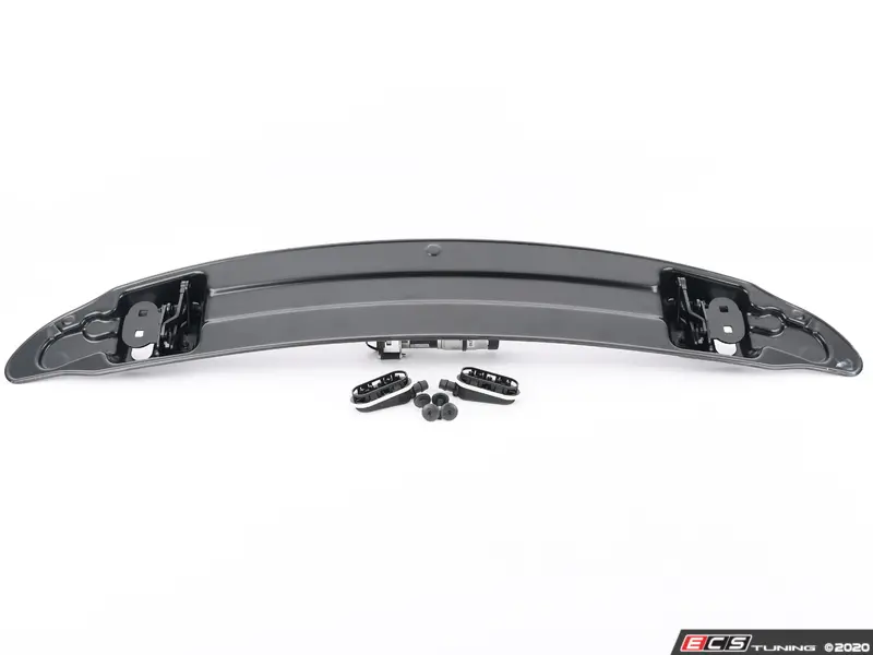

Hello, you can try to find the guts off an R58 or R59. Or get the spoiler replaced. My guess is it the motor or bad gear in the motor or linkage. This is what it looks like new. The fixed wings are now nla, so unless you find used.
R59 wing active wing
https://www.ecstuning.com/b-genuine-...e/51627400303/
https://www.northamericanmotoring.co...e-spoiler.html
Many thanks for the information.
