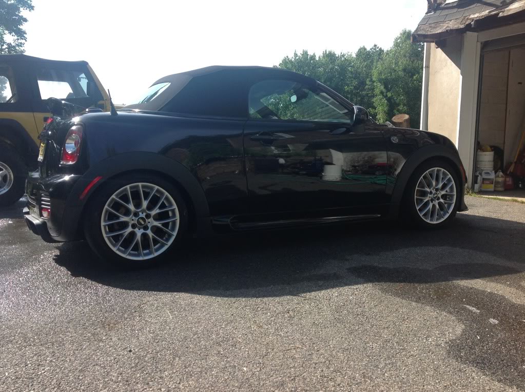

Have any photos with the NM springs with 215/45/17 ???
Old Oct 25, 2013 | 07:07 PM
LTLMCPE's Avatar
LTLMCPE
Joined: Apr 2004
Posts: 240
From: Chicago N burbs
Yes I do!
Old Oct 26, 2013 | 02:55 PM
NewCooperFanatic's Avatar
NewCooperFanatic
Joined: Jul 2011
Posts: 1,025
From: Los Angeles
Originally Posted by LTLMCPE
Yes I do!
That's awesome, first picture I've seen with 215/45/17 lowered on NM springs.
Been contemplating doing that as I don't have a need for coilover(daily driver), but I'm running a 17x7.5 et 40 offset. Which might rub with a 215/45/17.
Are you running a fair amount of camber to reduce that scrub you get?
