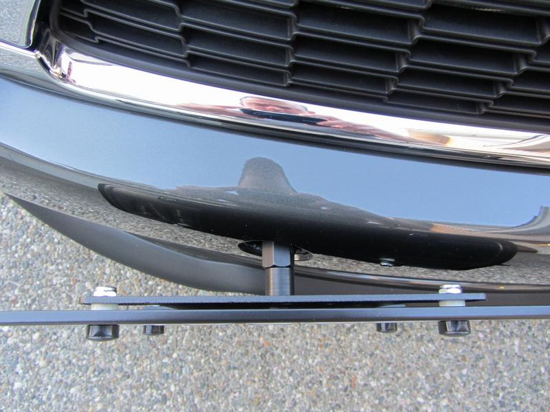

So back from the dealer and the Craven speed mount did not work. If you screw it all the way in, which you have to, then the backing plate wont clear the bumper let alone any screws that have to go through it. But I called Craven speed and they are sending me a spacer and longer bolt to extend it so it should work out. I will post back when I know.

That is because its bout 3/4 on an inch to short.

Talking Works with the spacer!
So with the spacer and longer bolt CravenSpeed sent me it works great. They also sent me some angle blocks incase I wanted to angle it out I think. It is almost too far off the bumper but really only about 1/2 inch at the closest. I may play around with the angle blocks to see if I like it more also.
If you get one I would just ask when you order to get the spacer and longer bolt. Im really happy with it. I may shave down the spacer a little but going to see how it goes for a week.
Here are some pics:
