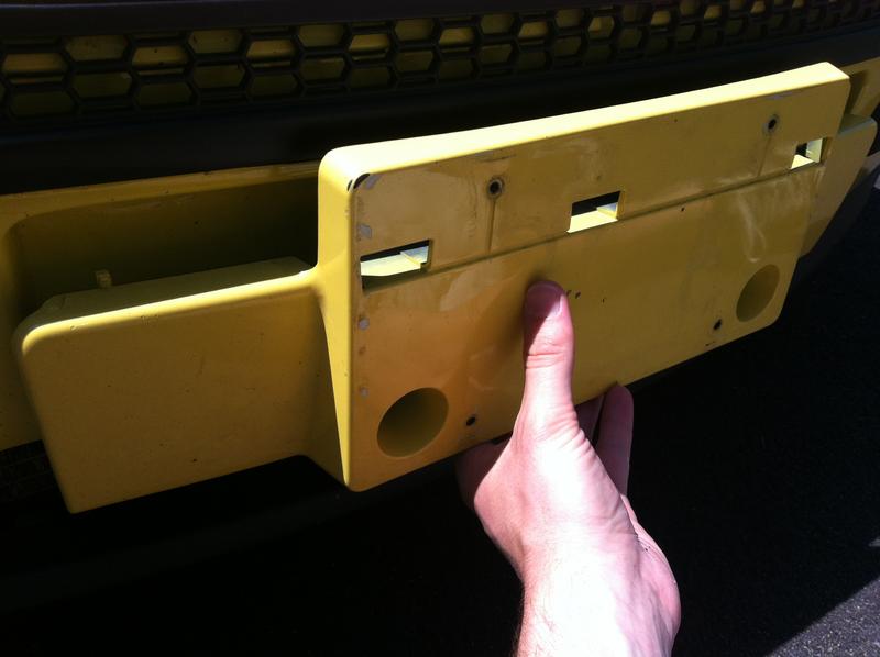

My R50 came with one of these installed.

Is that the OEM mount that came with your car? The ones for mine are drilled into the bumper, not something I am willing to do.

That is the OEM mount that came on my R50 - tho that photo was found on the web. Does your bumper have the recess for the mount - originally made for Euro plates.

I have the OEM mount shown in the post from ECS on my car, but without drilled holes. It clips into the lower section of the main grille, and hangs low enough that I can use some stiff wire to go from the lower corners back to the honeycomb bottom grille to secure it. I don't have it on all the time, just when inspection rolls around (the cops here in NH don't look too carefully I guess).
Honestly though, 3M Command adhesive strips could work too if there's enough flat surface on the back of the mount. I've got the front plate on my VW held on only with 3M strips now for 4 years - I think I changed them once just to be safe. You definitely don't need to drill, as there are other ways. If you are going to have it on all the time, I recommend putting a strip of clear protective film behind the mount so it doesn't scuff your paint where it touches.
