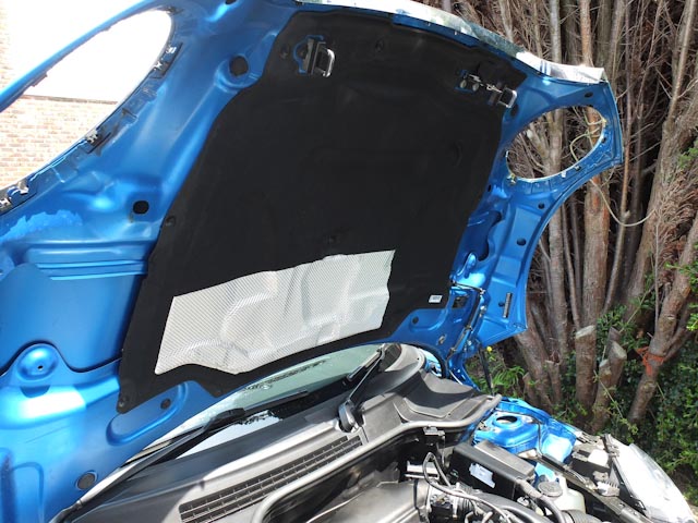

Go to the dealer + explain that you'd like under-bonnet insulation for your coupe. Tell him his computer might 'point' towards a part designed for a MINI D (turbo, silver heat shield at the rear + no air-flow hole) but that you'd like one that will accomodate an air scoop hole like the R56 pre-LCI MCS used to have and also has the turbo heat shield at the front.
I think I've attached a thumbnail showing mine in situ. It's held in place by 10 plastic rivets, listed with the part. I might not bother cutting an air-hole in it; I'll see what the engine cooling fan does initially...

FrannyB. Look at my post #151 above.
My attached photo in this post shows what your insulation should look like except it's not quite correct since my silver heatshield is at the back of the insulation for a different turbo position (diesel application) even though it's the only one listed for the N18...
BUT your wrong heatshield is worth keeping to stick over the top of the black fabric insulation that they correctly get for you. It's an extra for the MCS turbo position at the front of the engine (rather than the diesel turbo position at the back of the engine) so it'll reflect away excess turbo heat. In the (proper, in my view) N14 version this is 'built in' to the black insulation fabric that fixes to the bonnet with plastic rivets. I bet their holes are in the same place as our N18, too...
Yes, whole this bonnet insulation issue doesn't seem to have been very well thought out by MINI does it? It's not even an after-thought yet! (Perhaps they rely on us customers to 'sort' their ideas for them. We must due show gratitude...)
