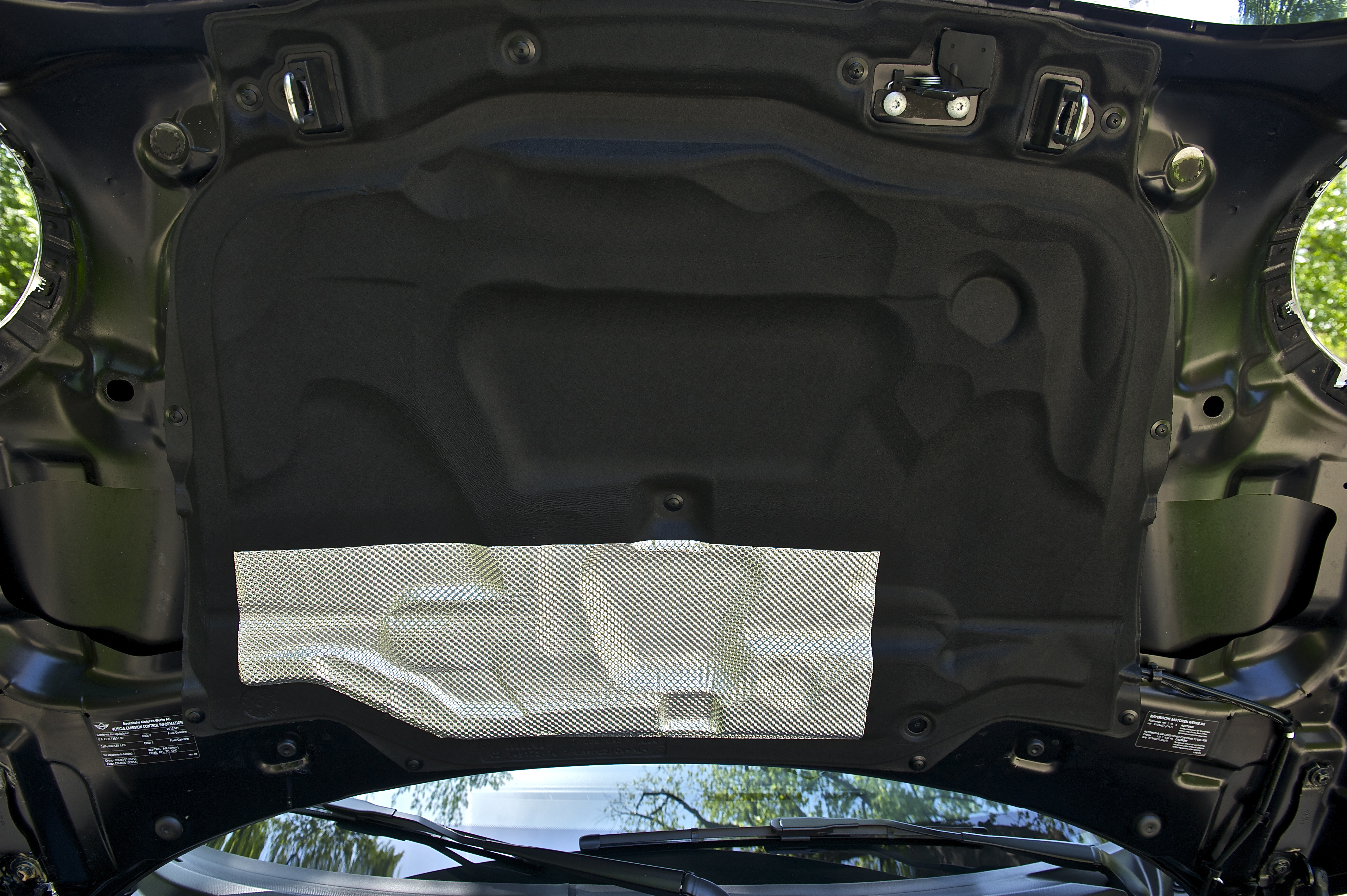

Hood Insulation Installed
Hi gang-
My dealer got the hood insulation in, so I made an appointment and had them install it. When we looked at it together, I was surprised at the placement of the metallic heat shield. I thought I would see it over the turbo, however, as you can see, it sits across the back above the intake. I drove the Roadster for about 20 min. and stopped to check for hot spots with my hand. Strangely, the metallic shield above the intake is a really hot area. Checking the hood on the outside, nearly cool to touch...really happy about that , no hot spots anywhere. As you can see, the insulation covers nearly all the hood surface. I'm debating on whether to open the area that would vent to the scoop. I'll run this for a while and get a feel for it. Also, it was 87 degrees here today and I didn't notice the temp. gauge running any hotter at all. Nor did the fan seem to be running any more when I shut it off after a long drive. I was wondering about trapped heat.
Here are the part numbers for what we installed:
51 48 7 266 543 Heat Insulation (1)
51 48 1 915 964 Expanding Rivet (11)
-Steven

This looks great and it appears that it works. I will be ordering tomarrow. Was the cost about what was quoted? Here's thanking you, Steven and your dealer

My MA was outstanding, following through and getting it done...can't thank him enough The cost was $145.00-insulation, $11.00- clips(11)
I did ask for a discount and they gave me one, although I would rather not say how much out of respect for the dealer.
Originally Posted by MsBrit
I did not get the insulation either......so can this be ordered and installed at home or does the service center need to be involved? I am over two hours away (and a time zone change) from my dealer so it wold be real handy if it can be done at home. Would you mind Steven giving me an estimate of cost?
MsBrit
You could definitely do it at home, as it is held in place by the clips. They were done in ten minutes.
