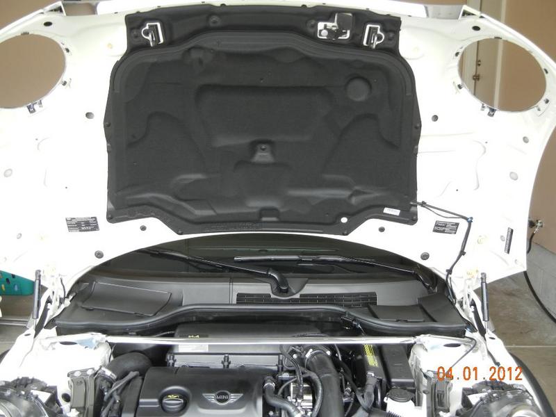

The insulation woes have been going on for a while. I have the insulation pictured above and it does almost nothing to stop the hood/scoop from getting hot. Atleast they designed something that works this time...

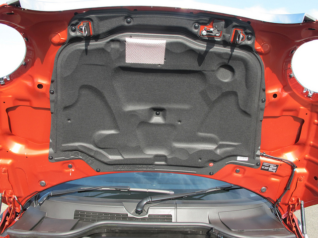

51487266543 as in post #151. - large turbo heat reflector at the back of the bonnet, nearest the bulkhead for diesel applications, it seems. (NAM won't let me reattach this image for some reason...)
51487307579 - no turbo heat reflector - image attached
51487334335 - small turbo heat reflector at the front -image attached

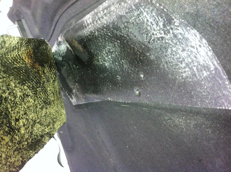

What do I find but evidence of heat - fire - pain - dismemberment. Okay. It's not that bad. But it isn't pretty.

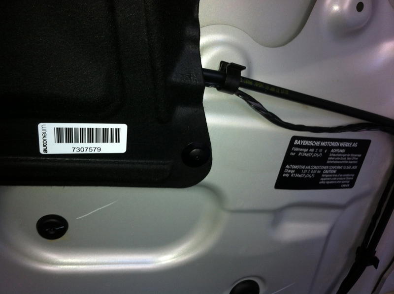

HOWEVER, my '13 Cooper S Coupe (Production Date Jan/2013) has the pictured insulation under the hood, and I can not find one hotspot on the surface of the hood now. Not one spot! I guess this solved the problem!
Poor iphone pic, but this is the one I have and shows it is Autoneum 7307579
Last edited by MakoBimmer; Apr 30, 2013 at 06:54 AM. Reason: Added picture of sticker on insulation
