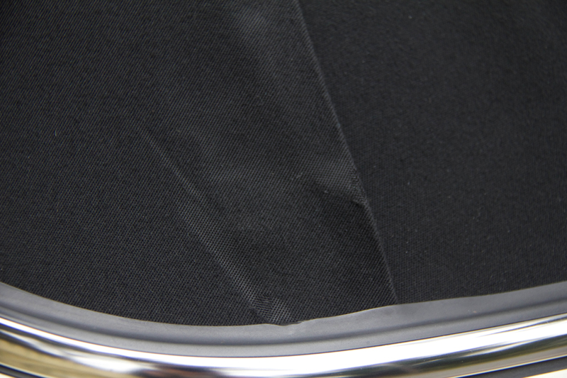

I have what "might" be considered the rubbing/wear and start of fraying on the fabric, and was going to mention it when I'm in for my first check up.
But I also may just be paranoid...

Don't be shy, take a picture of the roof and post it. It helps to get a second opinion.
Finally had a chance to take these...
Anyone care to give a prognosis? Note - both wear patterns are symmetrical on the car.
The 1st is roughly by the door edge on each side, the 2nd is on each side on the rear of the car
This is the same problem I have. Mini USA and the dealership have indicated that this is a "normal" wear pattern for 2009 tops. Thus no one will take responsibility to correct the issue. I don't think its normal. If the wear gets worse my husband is going to be more aggressive to have the issue addressed.
I love the car so much I'll put up with it, but if the top needs replacing...there is no way I can afford to fix it.
