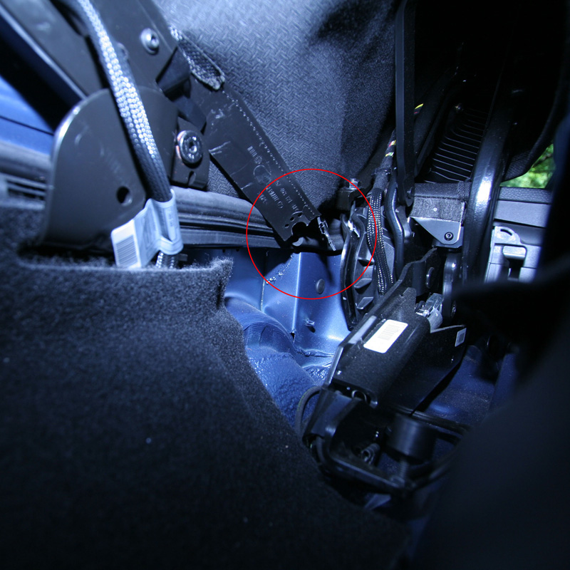

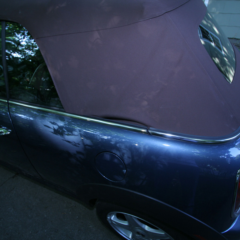

2009 Cabriolet Convertible Top Problem
This issue, on the same side, happened to our car TWO days after we bought it. The plastic piece sewn into the top that clips to the side of the car behind the driver's door is broken in half, so top hangs free from the body in that place. Luckily Motor City Mini (outside Detroit) is dealing with it fabulously. I called them about it, and instead of having us drive 1.5 hours there, they just asked me to email them photos of the issues. I emailed them the two photos below, and they were able to ascertain the problem and order a new top without my going there. Now that's a level of service I have NEVER experienced at a car dealer. They said the top should be in next week. They didn't even mention that this might be vandalism or any other such nonsense.
Like PhillyMCS's, the top still works fine, and we've been driving the car, although it looks like the problem compromises the seal to the car, so we're not driving it in the rain for fear of getting the trunk wet and moldy. Car's really not as much fun in the rain, anyhow.
PhillyMCS, was your car a very early build? Maybe one of the "launch" Cooper S convertibles that was yellow with (I think) the bullet wheels? I ask because although we just bought our car, it was one of the original base Cabriolet "launch" vehicles, so it was a very early build. The base "launch" cars are horizon blue over hot chocolate with a hot chocolate top, and they have some odd options like xenon, dynamic stability control, and rear park assist. Anyhow, given that we both had the identical problem with the identical part, I wonder if it was just a problem with the very early build Cabriolets.

Mike- That is exactly what my top looked like. However, your dealer was gracious enough to take care of the problem with no questions asked!!! I'm glad you didn't go through the battle I was put through.
Yes, my car was an early build since it was a launch car. But, the dealer that fixed the problem doesn't feel it was an early problem or not, but rather it's just a problem MINI has to address sooner or later since they did see other later built cars with this same problem as well.
