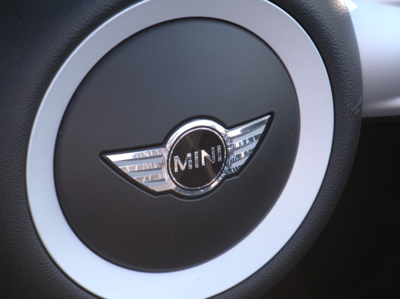

Here is ia pic of my aribag logo delamination.....i took it to the dealer and they ordered a whole new airbag under warranty.
That is a strange failure. Are the edges sharp or is the "chrome" plastic?

Posts: 68
the surface is smooth, but the chrome under the plastic is seperating, so it looks cracked underneath.
