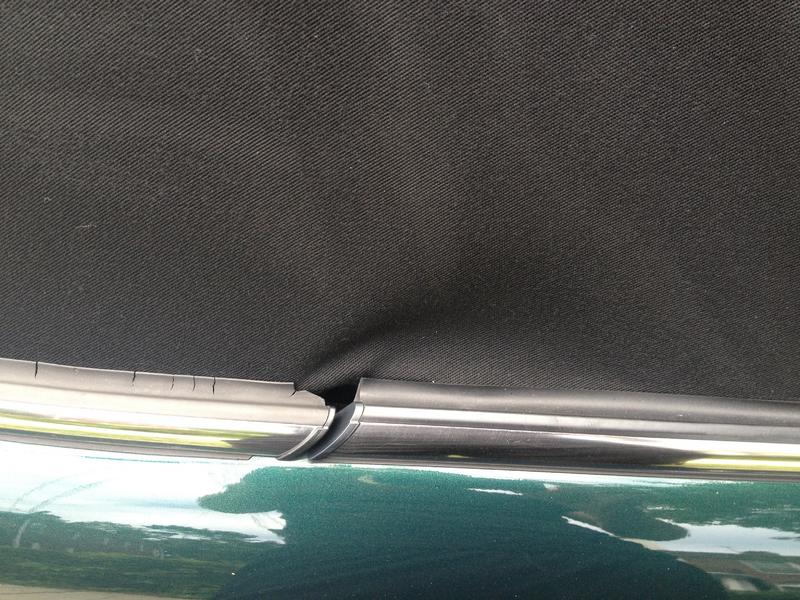

photos look normal. I have a 2009 mcs convertible and the top separated at the point shown in your photos and the parts holding the top there were plastic instead of metal. after they were replaced there is still a small separation but this is normal.If you can run your hand between the top and body to a point past the second knuckle then you may have a problem but from the looks of things I doubt you can. Mini switched to the plastic parts in either 08 or 09 to save money but after having to repair many tops for the separation problem because the plastic parts broke I believe they went back to the metal parts in "10. Just have the service dept. check the next time you bring it in.

It shouldn't be like that. That beltline joint doesn't look like it is lined up correctly either. Is it possible the top has been replace recently? Is the fabric solid black all over with no shiney spots from friction of being folded down a lot? They'll get that way after a while. If the canvas looks new then whoever replaced it maybe needs to give that spot another try. The outer canvas is not 'water proof', but water resistant. It has a water proof liner underneath. You want to get a good canvas treatment and use it regularly. RaggTopp and 303 fabric guard are the best and most often recommended.

You have a broken fastener on that side. My replacement tops have continued to use plastic parts there.

Thanks, I will check with the dealership where we bought it.
I think the car was built in late October or November of '09.
Fly'n brick, it has been pretty wet here, and that top definitely does not have any protectant on it. It is soaked. Once it dries out I'll check for shiny spots. I feel like there may have been a shiny spot, but I can't be sure. Thanks.

I had a similar issue and they replaced some fasteners or clips underneath the top. As far as waterproofing, I talked to a local top installer who said there was no reason waterproof the top. I'm interested in what other's experiences are.

That looks like a clip is broken. I'd take it back to the dealer.
I agree. If you look at a previous post of mine I posted two pictures that look similar to that. I brought it in when it was time for it to be serviced and pointed it out to the dealership and they replaced both sides with the kit. My car is 2010 built in late 2009.
