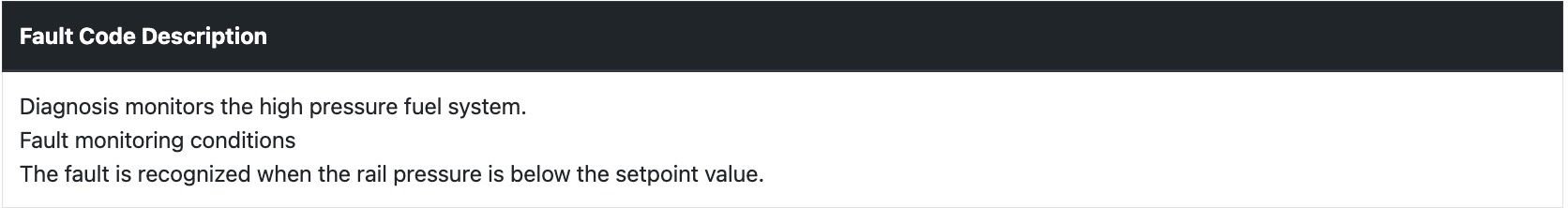

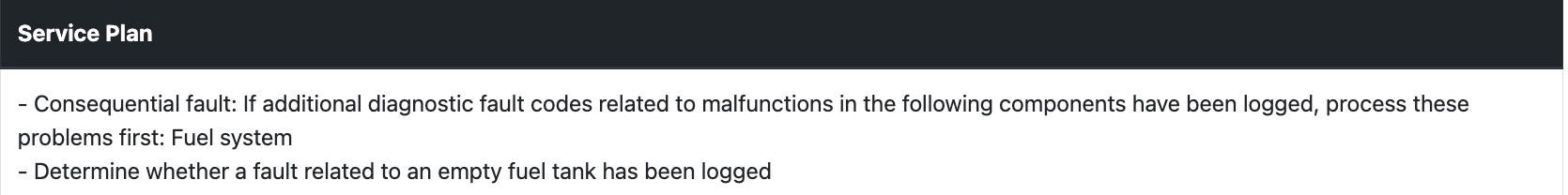

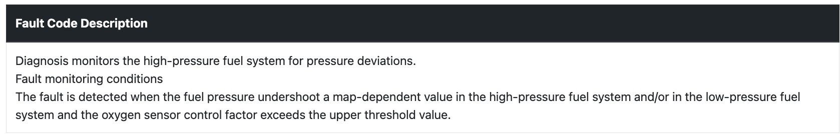

This^ idea remains a possibility as a problem with the low-pressure side of the fuel system can't be ruled out at this point...
For example:
Code 2BE9
Code 2C01

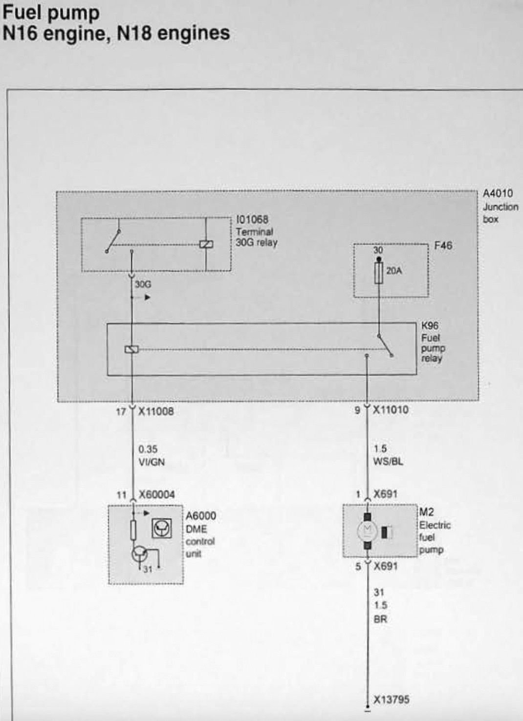

...it seems like I either need to tear apart my JBE or splice a bunch of wires in the kick panel fuse box.
Your recent stalling engine is consistent with the idea, but to properly verify, you would need to show that the stall was caused by a failure of the LPFP to run. Or if at some point, the engine cranks but won't start, the diagnosis could be made by showing that the LPFP doesn't run. Otherwise, you would need to remove the JBE, separate the two JBE boards, and then inspect the terminal 30G relay for a bad solder joint.

The way I repaired it was actually simple. I removed the fuse box and took out the module where the relay is solder to. It's actually 2 printed circuit boards stacked together. They are connected by pins that I carefully cut. You'll have plenty of room to cut these pins. Next I examined the relay and noticed that the solder joint was in bad shape which explained the internment running and not running of my car (heat caused the solder joint to fail, which is why the car ran fine when first starting). I re-soldered the pins on the relay and reassembled the two circuit boards by soldering the pins I had cut.
Here is a video showing basically what i did. Only difference was I didn't replace the relay. Just re-soldered it.

And with all of these codes, it's almost got me a little worried that it's an FRM issue, which I've heard is not exactly cheap.
These^ CAS and FRM fault codes are also potentially consistent with a bad terminal 30G relay.

I just got back from two roughly 20-minute drives at a relatively consistent 40-50 mph where the car stayed at operating temp for about 30 total minutes, and no problems during that time. I've only reset the ECM memory so far, haven't touched the relay yet, but the car was noticeably better. Any chance it was just that? I know I'm reaching here and it likely is the relay at this point, but it would make me a lot more comfortable to do the relay as a precautionary step rather than a mandatory step.
Also, I've seen a method on here that some submarine electronics dude did that basically bypassed the relay altogether and used a 20 amp fuse in the kick panel instead. And another guy on youtube did something to tie the LPFP (video below) into the rear cig lighter. I'm liking these two options more because they completely bypass this JBE relay which just seems like an engineering fault more than anything. Any words of caution about either of these alt. methods or are they totally vaild? I'm aware that these methods mean the fuel pump will be on in accessory mode, but I don't sit in accessory mode hardly ever (unless I'm diagnosing).

One downside for bypassing rather than repairing or replacing a faulty terminal 30G relay is that the latter relay has multiple other functions besides supplying voltage to the LPFP relay. If you choose to bypass the terminal 30G relay, you will not regain its multiple other functions.
