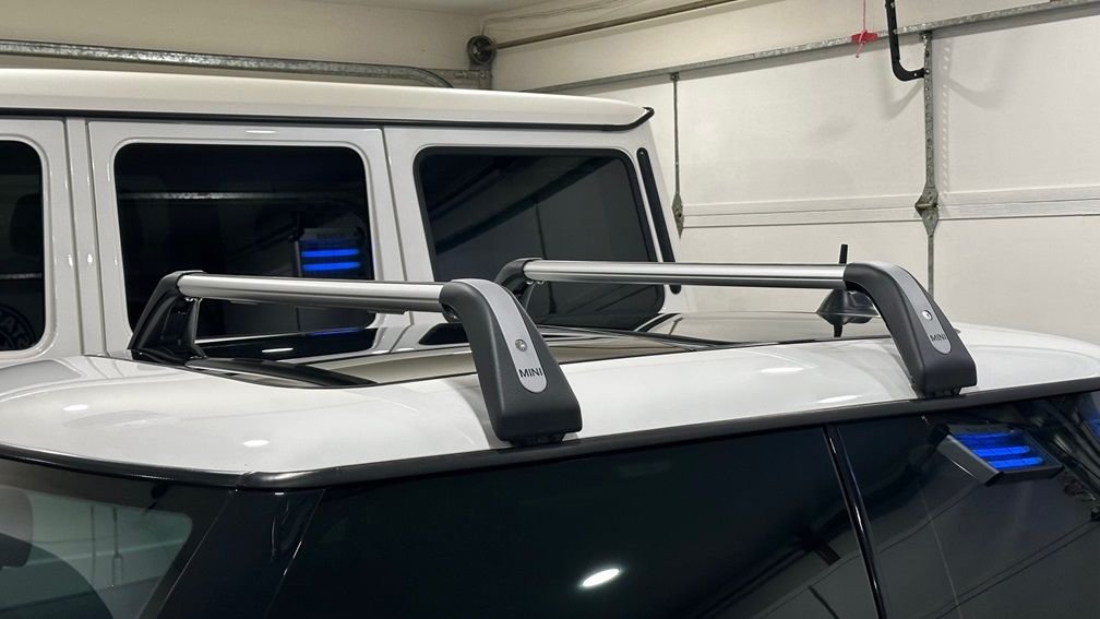

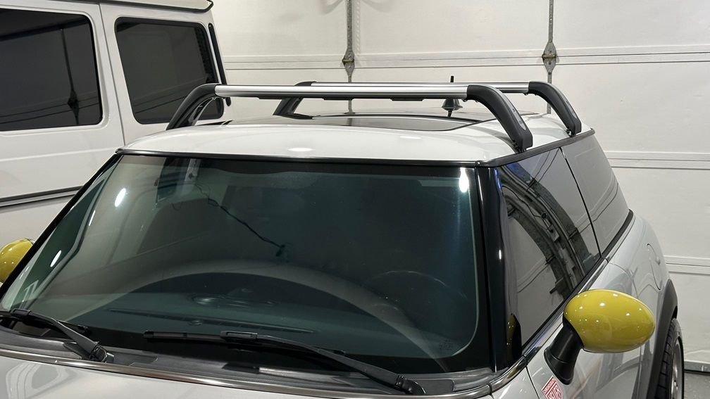

Holy cow - these are THE hardest roof racks I ever installed. Took me over an hour to install.
Why is it soo hard? Old tech? I do appreciate its not a gutter mount.

I only install mine when I need them, then they come back off. They can gat noisy on the highway, and I do a lot of highway driving. The more you put them on and off, the better you'll get at it. I can install them now in about 15 minutes, taking my time. It helps to loosen the cross bar bolts so the end clamps can float. Then, once the end clamps are positioned and tightened down, snug up the cross bar bolts.
