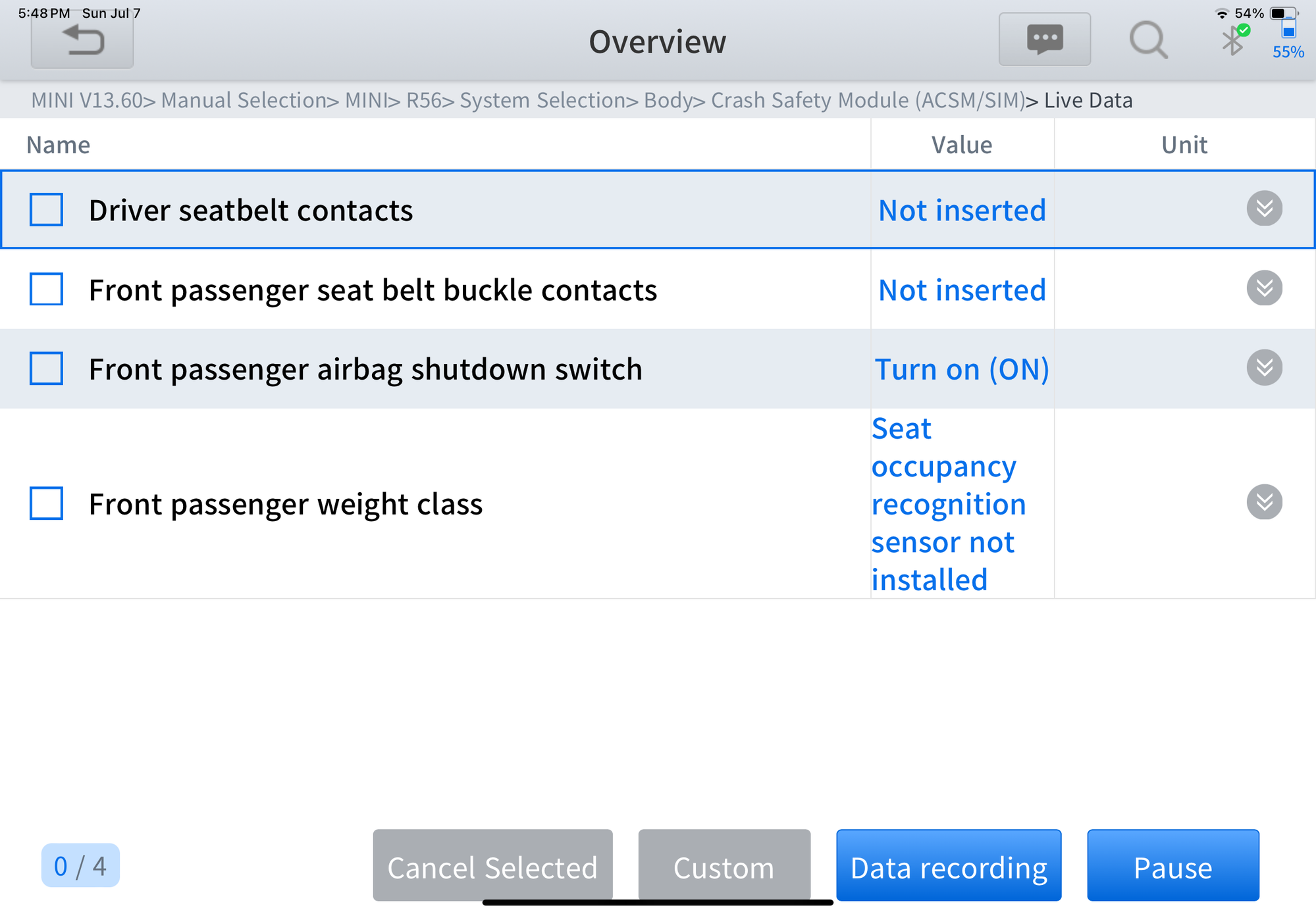

I need some help. I’m working on my daughter’s 2013 R56 that had intermittent airbag light/warning that soon turned into a constant. After checking codes, I got a 93c3 code indicating that we had a faulty OC3 Passenger Seat Occupancy Mat. Unfortunately, this Mini is outside of the service bulletin warranty extension for replacement. I confirmed this with a local mechanic and was given a quote of close to $1400 to replace it. I was floored with the cost and needing to save money, I replace the mat/cushion myself (https://www.turnermotorsport.com/p-5...eat-upholster/), which saved me about $1000. Installation went smooth, but now I get a new code 93c5;
I’m using an XTool A30M for diagnosis, but it’s not able to clear the code or initialize/register the new replaced part. The XTool airbag repair fix tool doesn’t seem to work on the Mini either. Is anyone familiar with this? I’ve read on another forum post where this part is supposed to be plug-and-play, but apparently there is some sort of registration that needs to take place. Several BMW owners report needing to go to the dealership to register/initialize the new part??? Anyone have experience with what I need to do next? Here is a snapshot of the Live Data for this
Much appreciated!

Originally Posted by Maybe, maybe not
If a replacement seat occupancy detector requires coding, you may need to upgrade your scan tool.
That’s what I’m trying to figure out, whether coding is needed or if I have some other problem, like a bad part or other issue. There’s not a lot of info on 93c5 code for Mini. It’s a common problem that a Mini mechanic would have run into, so hoping one will read this and advise.
I would assume that coding is required. If your scan tool doesn't do coding, then shop for an upgraded scan tool or pay a shop to do it.
Why would you assume this? Again, looking for responses from those with experience.

This is the thread about it, I listed all the info there:
https://www.northamericanmotoring.co...placing-3.html
"Replaced the seat cushion and cover. It wasn’t that hard dealing with the hog rings. I have a new error code 93C5. In googling it seems I need to recode the airbag module. "
I would take it to the dealer and have it recoded. I dont think some of those aftermarket tools can recode that since its a safety thing.

Thanks! The 93C5 code seems to be the result of removing the seat (unplugging the harness) without first disconnecting the battery. This seems to explain why some had no issues replacing their mats and others having a code they can't clear. I'll look around for a mechanic or dealership that can clear this up for me.
