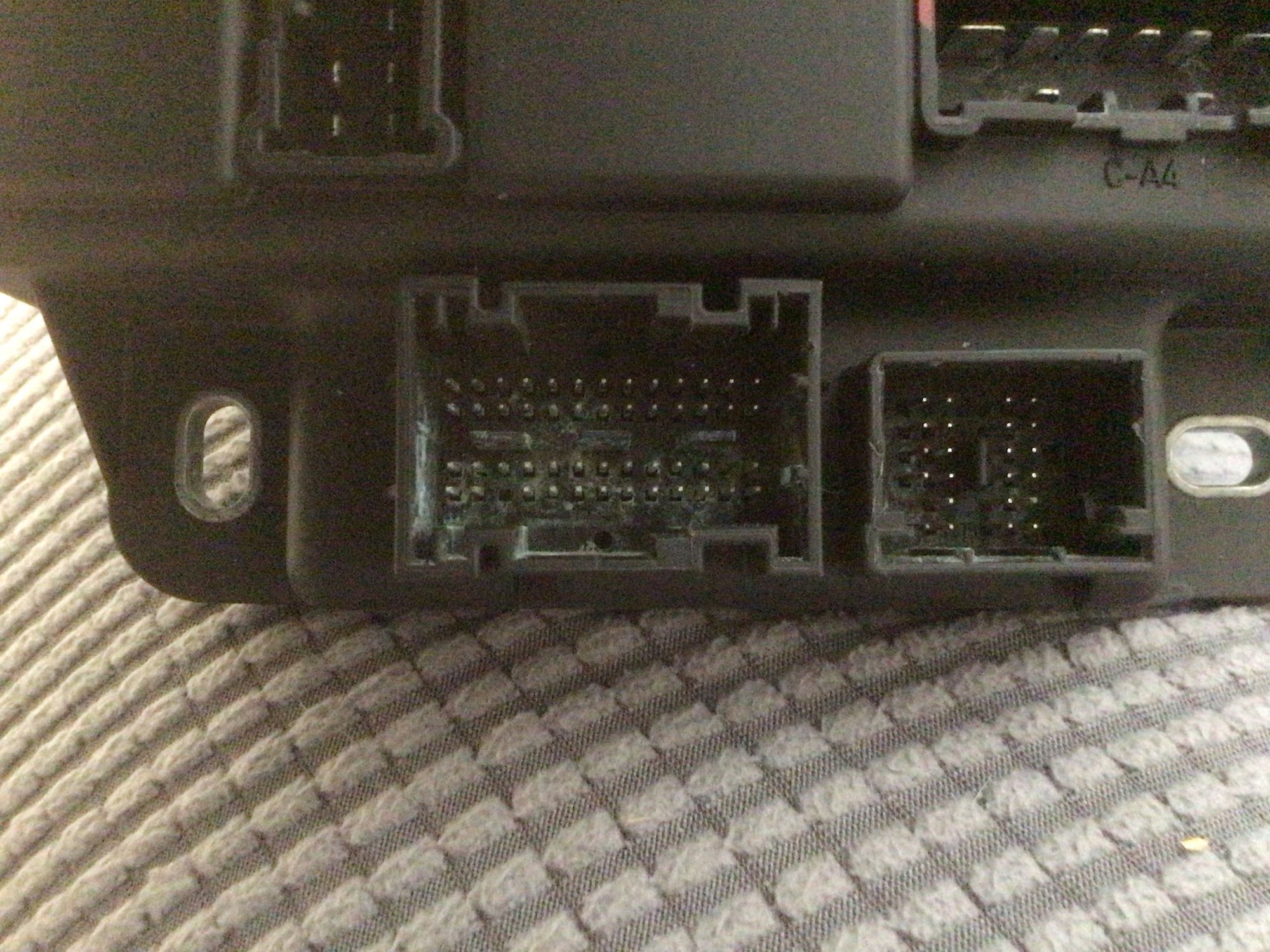

Think I narrowed it down to the corroded contacts in the footwell fuse box. So bad that three of the pins on the lowest connectors have disintegrated. Have to replace pin connectors in the terminal blocks. That is after I remove the carpet to dry it out . Ask me why I don’t want a sunroof…

Thanks for sending the info and images. At the present time I am removing the carpet to dry out the interior as I think there is about a half inch of water in the passenger footwell. I have gotten the correct fuse panel to replace the fubar’d one. This car has a lot of weird problems that I think were being caused by the damaged fuse panel. It has been wet a long time. As soon as I get it all sorted there I am going to go over all grounds and voltages and maybe it will run!

Yep FRM got wet. Their is a recall for certain models: https://www.northamericanmotoring.co...-incoming.html

Soaked is more like it, pulled the carpet out and it has been hanging every day in the 90 degree heat for 3 days now and I can still squeeze water out of the foam padding attached to the bottom of the carpet. Hard to believe that all that water came from the sunroof drains but I guess it could have been in there for a while and just kept building up. Need to invent a waterproof cover for the footwell module and the fuse panel. Need a thinking cap.

yep we have the drains fix kit linked above, MINI has not released the full fix for the FRM yet, my guess is new water resistant module and maybe a drain fix or TSB. My MINI was not on the recall, but i bet someone will post up what was done.

Wonder of wonders, after changing the fuse panel it actually started and ran and the headlights work again. Now on to other problems..
