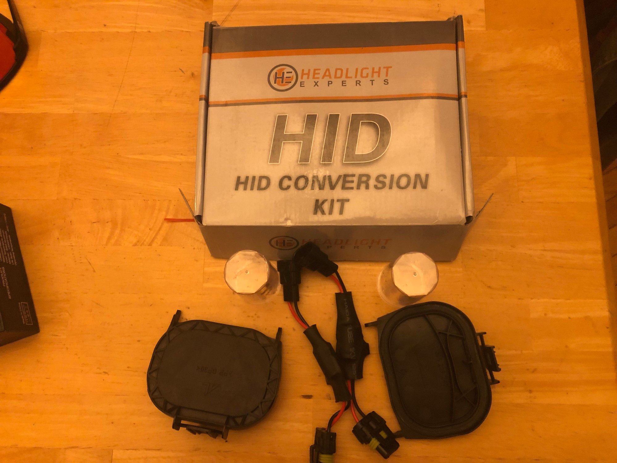

These packages were in the trunk so I’m assuming this is what was used
the LEDs I think are in the fog lights.

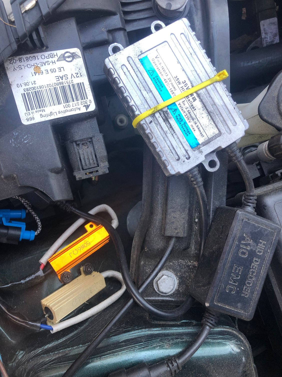

Without knowing how the HID retrofit wiring was performed, could be anything on the car. It is even possible whoever did the conversion wired them straight to the a switched power source, bypassing the headlight stalk.
but then he'd be getting a bulb out warning message.....
