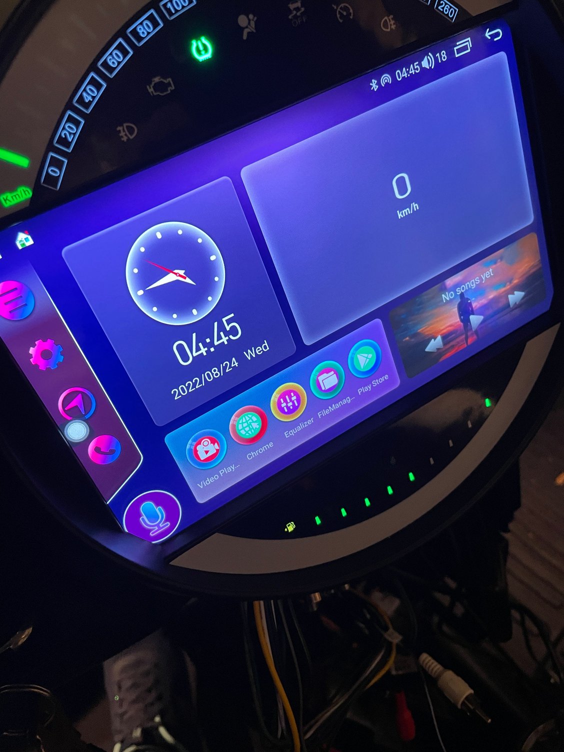

Hi everyone
i have 2013 mini cooper s and i bought one of the new head units that comes with a touch screen and carplay i bought it from ali express (hopefully i it is not a huge mistake) had everything installed and it is working fine except when i plug everything the lights in the tachometer doesn’t work however the screen in the tachometer works it is just the lights that doesn’t when i just plug the old tachometer everything works fine but i am wondering if anyone can help me figure out the issue or at least direct me in the correct direction
This is the screen i am using
When the new screen installed

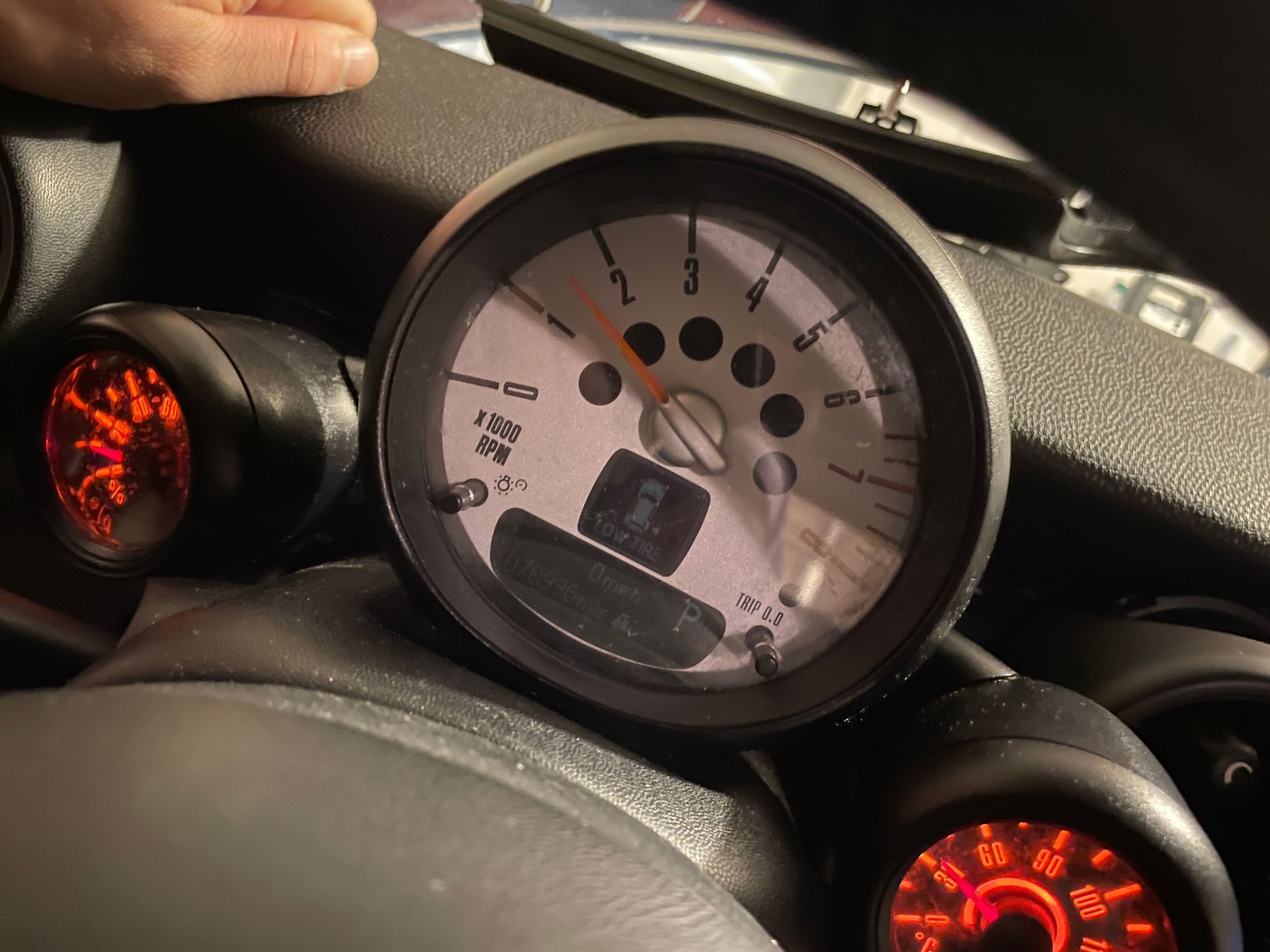

This is the original speedometer
Everything goes back to normal when i plug the original speedometer

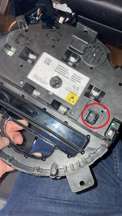

Mine did the same thing. Ended up being I had the cable circled in backwards. Not a fan of their plug in, could go in right or wrong.

I had to look around, I finally found the picture of my Tach without the backlights working when I did that.

Yes, in my 1st reply I circled the connector to the Android radio that I had in upside down or back wards. That plug could go in either direction, the way I had it in originally was wrong. Flipped it 180 and plugged it in and problem solved.
The plug is what communicates with the CAN system of your car.

i tried to flip it to the other direction it doesn’t look like it wants to get plugged i have been trying to over an hour it is just not getting plugged
This extra plastic piece is preventing it from getting plugged

I have the exact same issue, did you manage to figure it out?
This is where my cable is supposed to be plugged in, I think, but impossible :(

in my case i had to return the head unit and buy another model it was so annoying but it tried every single way to connect it and couldn’t get it to work so i just purchased another one that worked just fine
